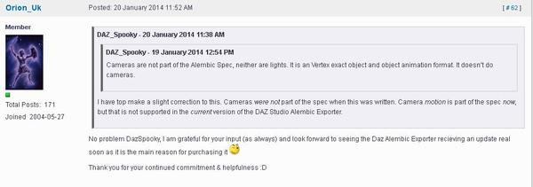

Cameras are not part of the Alembic Spec, neither are lights. It is an Vertex exact object and object animation format. It doesn't do cameras.
I have to make a slight correction to this. Cameras were not part of the spec when this plug-in was written. Camera motion is part of the spec now, but that is not supported in the current version of the DAZ Studio Alembic Exporter.
I have top make a slight correction to this. Cameras were not part of the spec when this was written. Camera motion is part of the spec now, but that is not supported in the current version of the DAZ Studio Alembic Exporter.
No problem DazSpooky, I am grateful for your input (as always) and look forward to seeing the Daz Alembic Exporter recieving an update real soon as it is the main reason for purchasing it ;)
Thank you for your continued commitment & helpfulness :D
