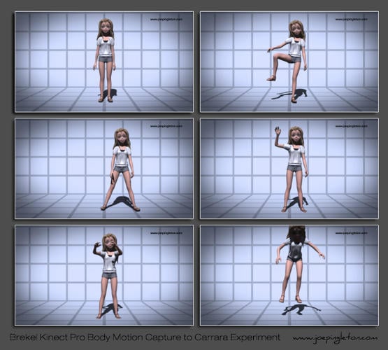

    View the motion capture animation on YOUTUBE.COM by clicking here.
    View the Stereoscopic 3D animation on YOUTUBE.COM by clicking here.
    Click here to see the 3D animation on 3DVisionLive.
    This is a another experiment with same technique as yesterday for Brekel Kinect Pro Body Motion Capture and Carrara Pro 8.5. This time I used a better motion capture BVH and a different Genesis figure. This experiment is all motion capture with no key frame animation.
    I think its my best result yet, what do you think?
    633 x 570 - 184K
    Post edited by Joepingleton on
