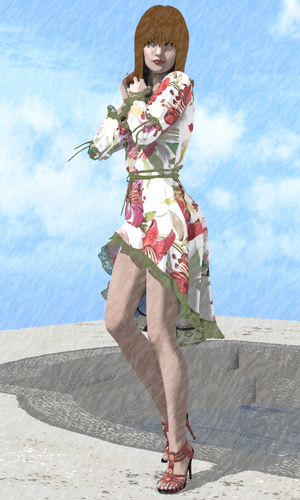

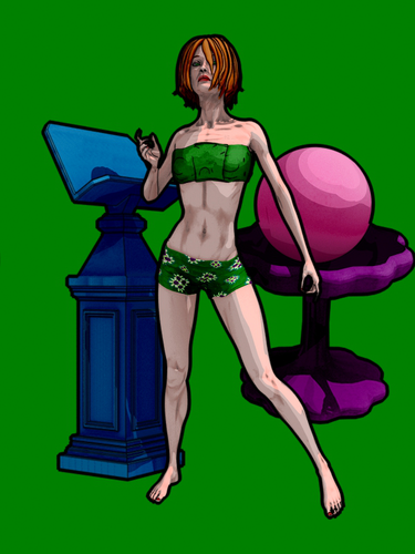

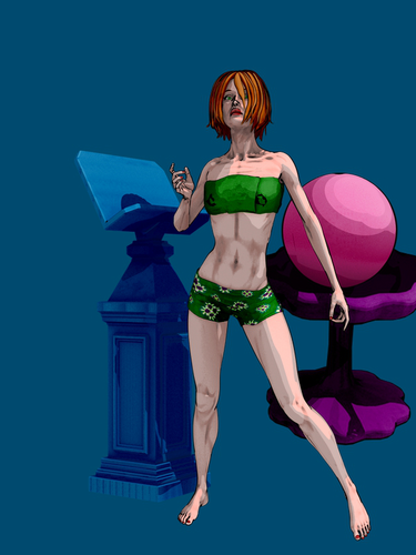

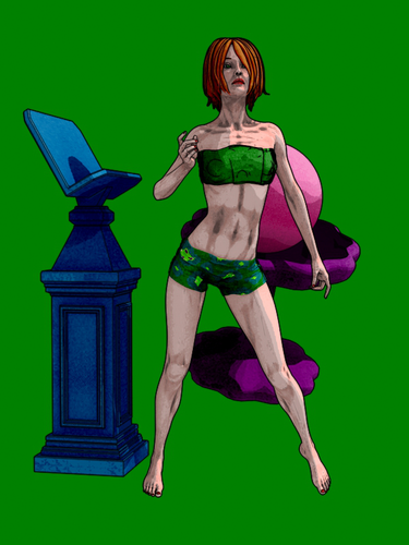

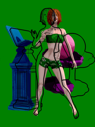

    1. Only my own shader with. See the shorts flowers. This is not a texture, it is a layered shader with texture in layers.
    2. TCam used, scripted 3dlight applied => Flowers????? :s
    3. TCam used, scripted 3dlight disabled, shading levels = 300, shading blend = 0, => Flowers!!!!! :D
    4. TCam rotated, scripted 3dlight even disabled => What???? :s
    5. TCam rotated, scripted 3dlight now enabled = Ahhhh.... :D
    When scripted 3dlight is disabled shading effects are gone, Tcam can't produce new outline, but remember last outline. Trick works for majority of my custom shaders with problems. In some cases, TCam shading effects improve my shader, so I don't need the trick.
    600 x 800 - 428K
    600 x 800 - 476K
    600 x 800 - 448K
    600 x 800 - 459K
    600 x 800 - 313K

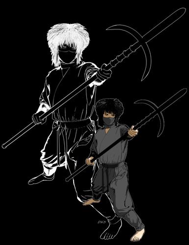

    Free sketch is super!!! I have curiosity about pro details.

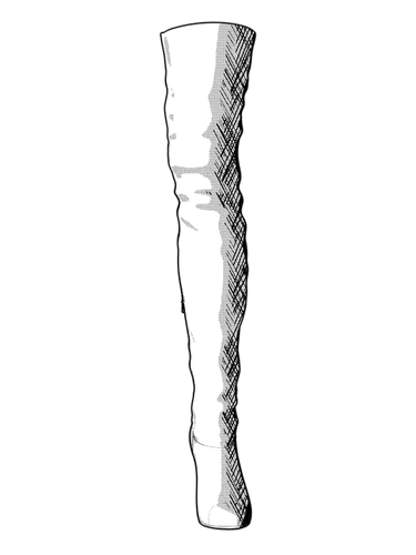

    600 x 1000 - 980K

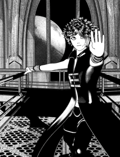

  • CybersoxCybersox Posts: 9,135

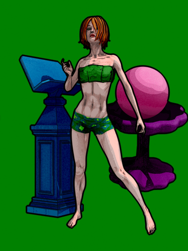

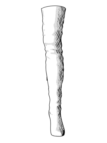

    Figured I'd go ahead and post one of my tests. I freely admit to cheating and using a little photoshop work to clean up some troublesome lashes and skullcaps, but there's definitely some unique new possibilities here...
    1131 x 1500 - 1M

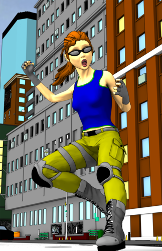

  • almahiedraalmahiedra Posts: 1,361
    This solve MStyle problem too :red:
    1. Only MStyle. sr = 0.05.
    2. MStyle + Tcam. sr = 1 changed for preset
    3. MStyle + Tcam. sr = 0.05 manually set
    4. MStyle + Tcam. sr = 0.05, sl = 300 and sd = 1 in camera parameter toon
    600 x 800 - 113K
    600 x 800 - 75K
    600 x 800 - 60K
    600 x 800 - 122K

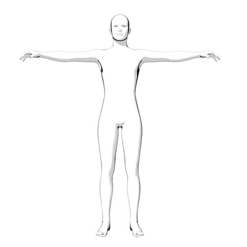

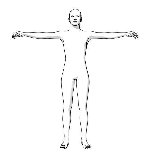

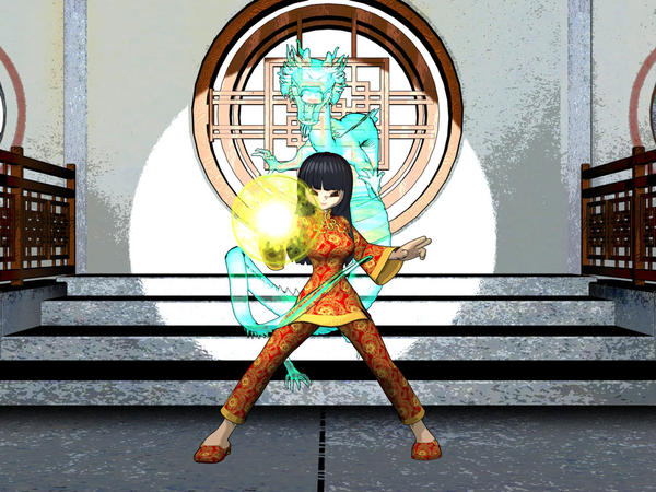

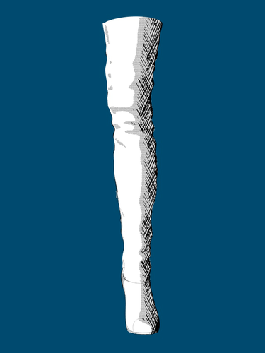

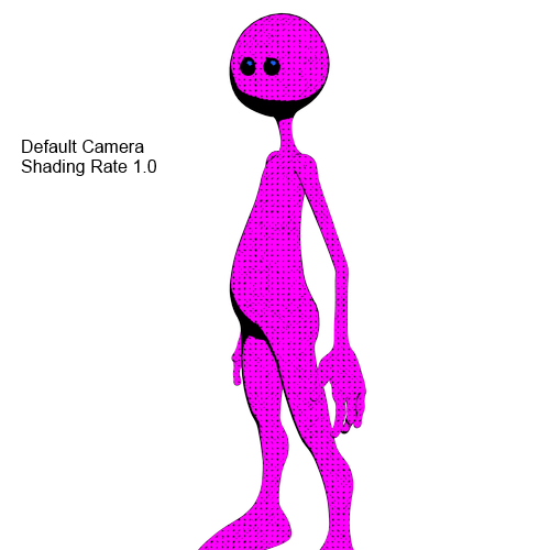

  • zigraphixzigraphix Posts: 2,787

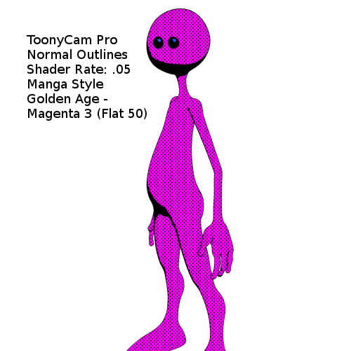

    I have confirmed the fix for Manga Style renders that gilikshe describes. See below. If the Shading Rate is too high, the distortion occurs in a default camera as well.
    Setting the outline width, because it is a Render Setting preset, alters the Shading Rate. Additionally, the Shading Rate has to be manually implemented as part of a Scripted Renderer setting, and I did set it to 1.0 by default. The attached screen shot shows where to reset it.
    437 x 626 - 33K
    500 x 500 - 76K
    500 x 500 - 85K
    500 x 500 - 62K

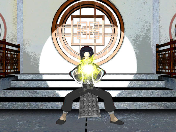

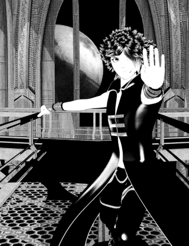

    And here's an improved version of my Manga Style promo image. Both the Default Camera and ToonyCam Pro versions are rendered with Shading Rate at .05. Much nicer!
    500 x 650 - 480K
    500 x 650 - 578K

  • nDelphinDelphi Posts: 1,877
    Another thing that I seem to have forgotten is that the shading rate I used on my previous Manga Style Shader renders is 0.010.
    That's why it worked the first time for me and then it stopped when it changed back to 1 as I was testing different scenes. I have to keep an eye out for this setting, as it really is vital.
    Lampeluche! XD
    Furify, Leatherize and TCam
    1200 x 1200 - 716K
    Much much nicer. I feel the printed paper!

  • wsterdanwsterdan Posts: 2,618
    A couple more quick tests (time is at a premium these days).
    The only problem I encountered was with outlines around the special effects; I rendered once with effects and once without, then merged just the effect. Ideally I'd be able to turn off the outline for just the cube and plane when rendering.
    Thanks again for such a great plug-in.
    -- Walt Sterdan
    1024 x 768 - 219K
    1024 x 768 - 200K
    -- Walt Sterdan
    In http://www.daz3d.com/forums/viewreply/556306/ dress have handles. This handles were outlined with normal method. Solution: Opacity strenght to 0% and a totally black texture inthe opacity texture.
    gilikshe said:
    -- Walt Sterdan
    Thanks, but I don't think that would work. The problem is that the special effects are textures on a plane, with an opacity map already set to allow the non-coloured parts to be invisible. ToonyCam renders the effect just fine, it just also draws an outline around the plane the texture is on. Setting opacity to zero for the plain causes the effect to disappear. I will try it anyway tomorrow, though, in case I'm missing something.
    Thanks again.
    -- Walt Sterdan

  • DaremoK3DaremoK3 Posts: 798
    Had a little play today...
    I don't have the fancy Anime/Manga shaders, so this is just playing around with straight ToonyCamPro. Testing dynamic cloth, and hair Ri-Curves.
    Gotta' say, I am quite impressed with it so far. Still a lot to learn...
    No retouching, just composite of two separate renders, and name added:
    923 x 1200 - 167K
  • eldileldil Posts: 14
    No Anime Shaders here either, so I tried a simple diffuse color on each surface.
    I used Outline ID and Depth on the figure (Didn't realize they would work together until someone mentioned it in this thread). I love how it brings some of the wrinkle details.
    Outline ID on the background, then layered them in Photoshop....
    1292 x 2000 - 3M
