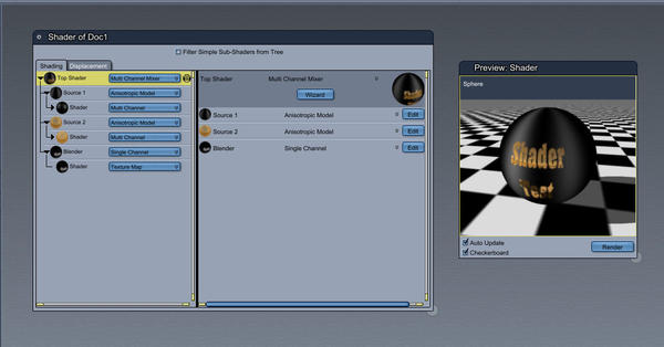

    Just a quick example of what I think you're trying to create.
    Multi channel mixer.
    the first shader is a Black metalic (anisotropic) shader , made with a simple black (Diffuse / Colour).
    the second shader is a Gold metalic (Anisotyropic) shader with a Mix of yelow and brown blended with a fractal noise.
    the Anisotropic part,. is a Lighting model, used for metals.
    The Blend channel is using a black and white texture map of text, (Shader test)
    https://dl.dropboxusercontent.com/u/7907045/shader_test.zip

  • BC RiceBC Rice Posts: 591
    So what I would want is literally the exact opposite. Can that work?
    I want the ball to be gold and the lettering to be black.
    Thanks!!!
    WOOHOO!!!
    Ha! That did it!!
    I dropped the black and white texture in the blender and booya! I just had to invert the colors since the background was white and the painting was black.
    THANKS!!! That is awesome. I would never have thought of that. And how fuggin useful is that for a whole host of things? Awesome.

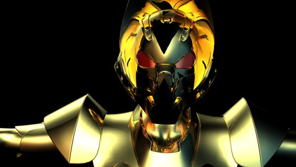

    I didn't actually do anything to the second source. It's just black right now, but I'll add in some shininess and highlights and all that to make it blend. But it WORKED...which is, like, so much happiness for me! haha
    Also, I will like never attempt to use 3D paint again. This is an infinitely more awesome approach.
    Ugh! What's sooooo cool is I get to actually have the paint react to light the way paint would and don't have to have it react like the metal underneath. Just perfect.
