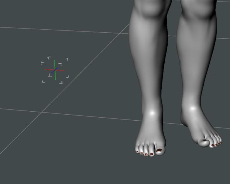

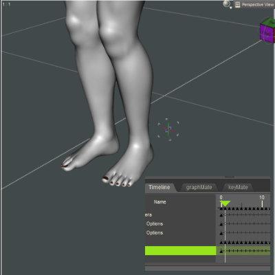

    Here's what happens. I put a Null at the toe of a figure which has an aniblock applied. Then I baked the frames to the timeline and the result, at frame zero, is a shift away from the original placement.In the second image you can see where the null is placed and that was where the figure was before the bake.

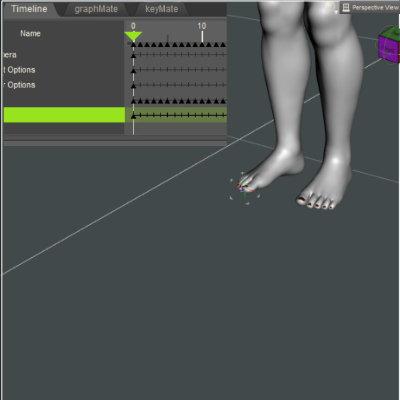

    This is a different aniblock ... and this one is fine [NOT - see next post].

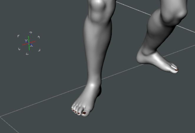

    Ahh, no - not fine at all. In the second example that I thought was ok, I advance the timeline just one frame and she jumped right out of position as you can see here...

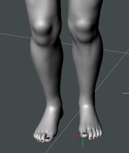

    So I did that test and found the following:
    1. If I test with a base G8F, I don't have a problem. I took the precaution of making frame 0 a keyframe before baking to the timeline and G8F did not move from the position I placed her at frame zero.
    2. I then tried with a character which is morphed and scaled so definitely not the base G8F. Otherwise I went through the same steps. Now I am back to having the character shift out of position after frame zero (i.e. there is a significant jump out of position at frame 1) when baked to the timeline.
    So, base G8f figure works fine. A character does not but I'm not sure whether it is a general morph problem or (as I suspect) a scaling problem. G8F is quite a tall figure so most of my female characters are scaled down. As this only happens after baking, none of the above tutorials about editing aniblcoks are relevant. However, there might be a possibility of just editing the aniblock and not taking the step of baking.
