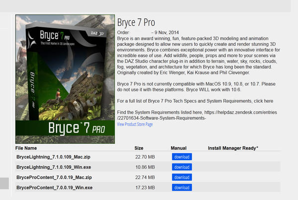

    I got brand new 64 bit computer with Win 7 64 bit. I got today Bryce 7 Pro. Before installed files vcredist_x64.EXE and vcredist_x86.EXE but install does not work. I do three install attempts on attached video, after 3rd install completes somehow but the Bryce never starts and is not present in start menu. No icon, only uninstaller is present.
    What to do? Help.
    http://youtu.be/DKhQ1mEUCGY

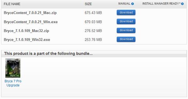

    edited November 2014
    How did you install Bryce, and did you install all the files. there are 4 in total, but you don't need to install Lightning unless you want to set up a render farm.
    The main program is Bryce_7.1.0.109_Win32.exe
    These 2 are the content files.
    BryceProContent_7.0.0.19_Win.exe
    BryceContent_7.0.0.21_Win.exe
    Normally you would install Bryce 7 first, and then run the vcredist_x86.EXE if you get the side by side error.

  • martinflashmartinflash Posts: 3
    I do something wrong, my files are only around 20 MB!
    I have bought Bryce Pro 7. Do I have to instal Bryce 7 first, where is the download link ?
    I have only the links on attached photo.
    1048 x 704 - 344K
  • FishtalesFishtales Posts: 6,169
    Those are the Addon content for Bryce. You need to download and install the program files as shown in chohole's first image.
    Check my screen shots You want the one Bryce_7.1.0.109_Win32.exe which is shown in the first screen shot
    OK. I found the problem. I had to install from the PRODUCT LIBRARY Bryce 7 first and the Pro after. I can not believe I was so blocked. Sometimes it happens. Thanks for Help.
