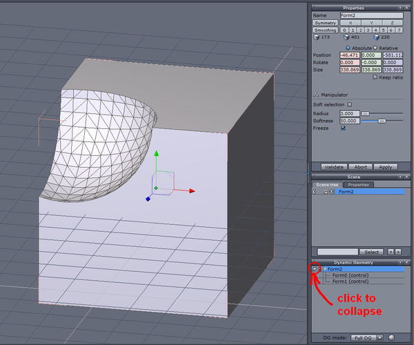

  • cdordonicdordoni Posts: 583
    Im not sure what you mean by collapsing?

    Ah collapsing the DG. Since I dont have it on at all, there is nothing to collapse. Hex seems to really implode if I do anything with DG turned on. If I go to extrude something with it on, kablooie! Project gone and I get aggravated. I was thinking there was an operation within Hex that was called collapsing, not the collapsing of DG.

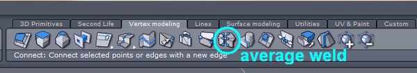

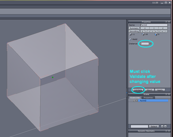

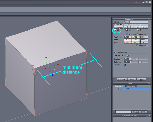

    Yeah, collapsing is specific to DG. I did read before that you said you were NOT using DG, so I included the screenshots to confirm that.
    Another thing I have noticed with booleans is that they often produce point very close together. I have found that this can be a problem for many future operations, not just booleans.
    So its a good idea to do an average weld on the object after a boolean. One thing to clarify on the images below, the distance value needs to be LARGER than the spacing between the points you are trying to weld and SMALLER than the minimum distance between the points you want to keep.
