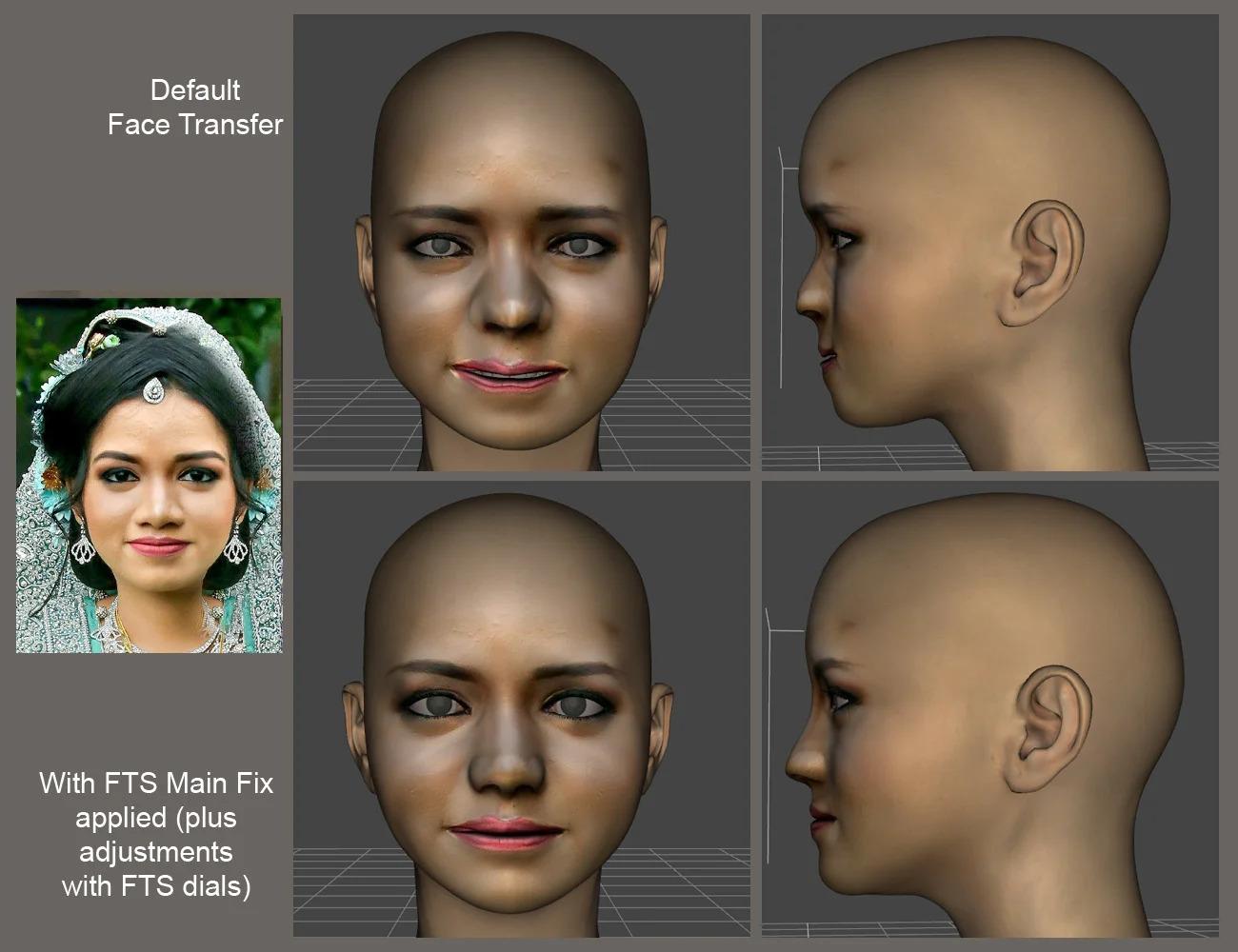

    First, it is a matter of opinion if you believe FaceGen is ahead of or behind Daz3D FaceTransfer, but as an over two decade user of FaceGen, I can say with certainty FaceGen is still ahead of FaceTransfer due to the Z-axis (front-back) issue with FaceTransfer that is not prevalent in FaceGen.
    Hell, Phil W had to create a product to compensate for this in Daz Studio :
    https://www.daz3d.com/face-transfer-shapes-for-genesis-8

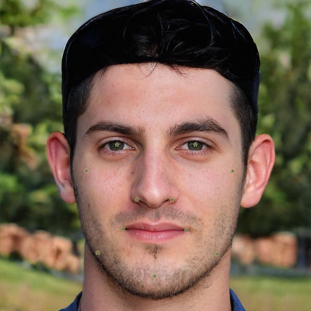

  • I just made some morphs with FaceGen. I'm using what I think is the most up-to-date version: does 8.1 as well as scans.
    The main issue is that the suggested dot placements on that tiny man's face are not accurate.
    This I found to work better:
    Centre of pupils
    Ends of the nostril holes
    Ends of the lips
    Not the bottom of the Jaw on the face, but the centre part of the lower jaw that juts out the furthest.
    Stay on the front of the face when placing the outside jaw and cheek markers.

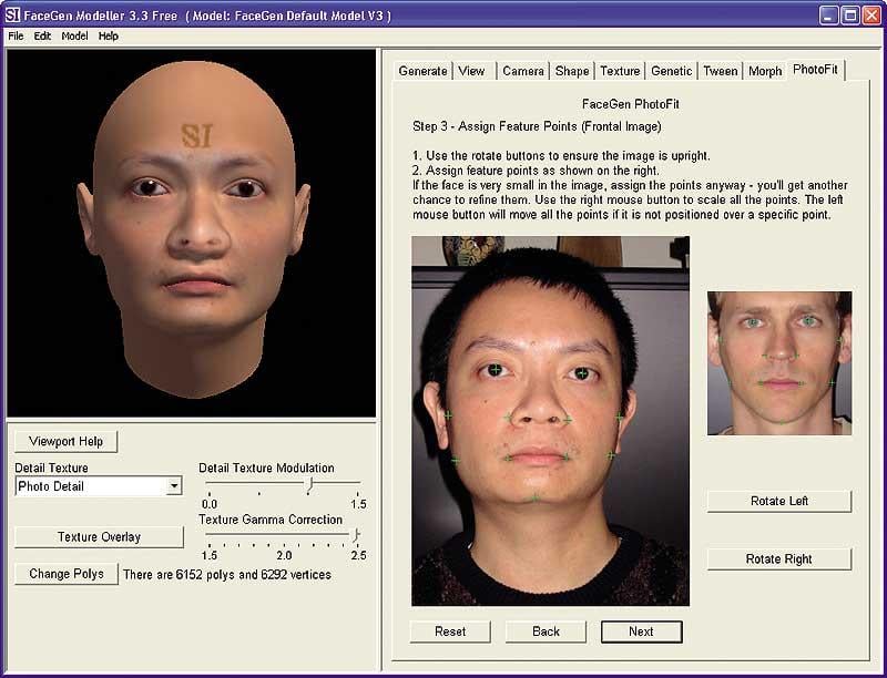

    So I took a break from coding and had a play in both FGArtist Pro 3.2 (I was wrong -- I have 3.8, but I guess I haven't even installed it yet), and FGModeller 3.22 (latest is 3.31).
    My post above relates to the original way to work with 'PhotoFit' as opposed to the current way it works.
    The plus for the new versions (both fgA and fgM) is they finally added a zoom function to allow you to set the points easier, but the negative is that they locked the points to a single click.
    In the older fgModeller you move the points around into position, and when you are satisfied with the locations, then you move on to the create stage.
    The trade off is more control, but on a smaller image.
    Older fgModeller example :
    Here is the last old school version (3.5.3) that uses this technique, and with arguably better creation/usage controls (Free for creation of .fg files/export disabled):
    https://download.cnet.com/FaceGen-Modeller/3000-6677_4-75322767.html
    Regarding placing points, Catherine is dead on  --  I will only add that I find setting points for the jaw to be in line with the mouth, and setting the points for the cheeks to be approximately horizontal to ear center (but this variates depending on the image -- ears above or below eyeline) or nose bridge center.
    800 x 612 - 63K

    Okay, this is of a non-real person. The lower jaw placement would be some trial and error - resulting in a long narrow jaw or a more rounded or squared off jawline. As to how wide the upper face goes - varies with the placement of the dots nearer to the ears. Our eyes perceive the depth, do not use the depth ... stay on the "flat" top of the face image.
    1024 x 1024 - 179K
