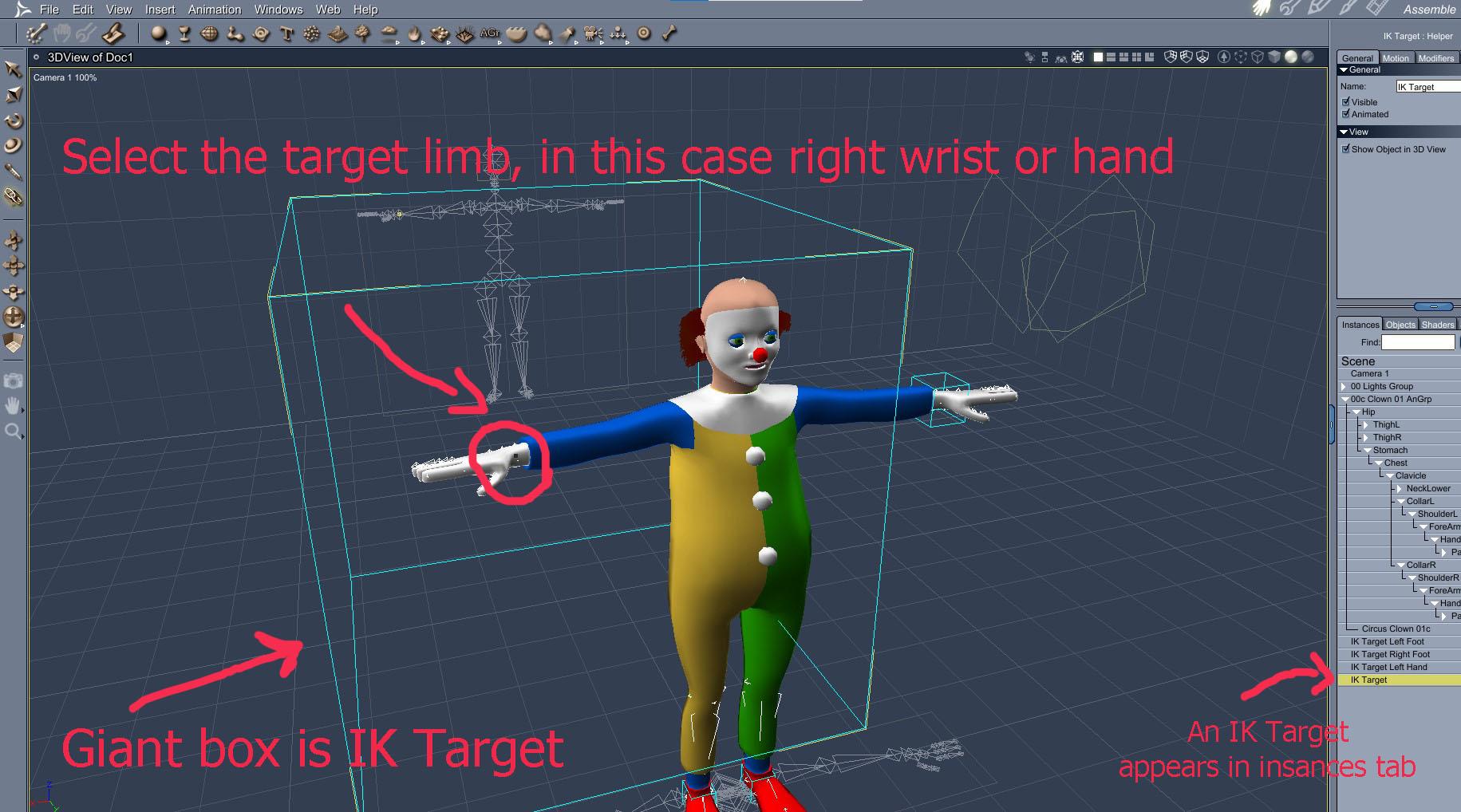

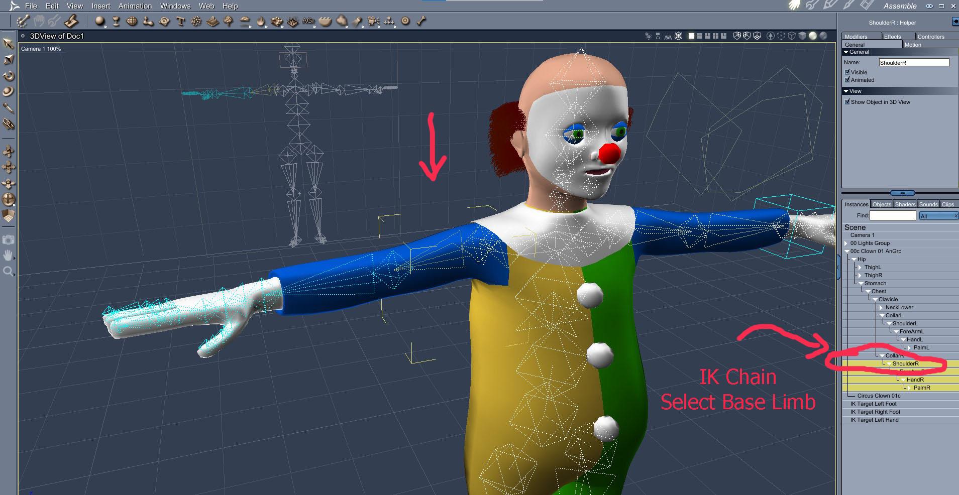

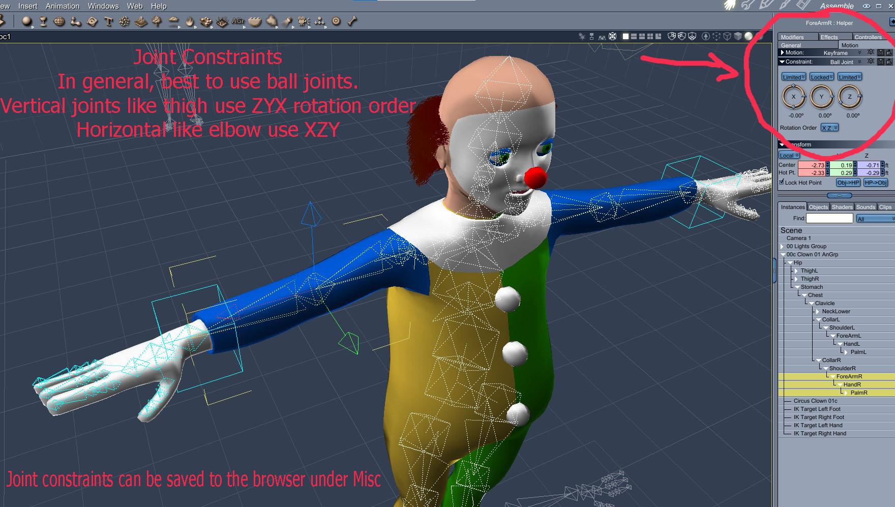

    Figure Prep for Animation - Joint Constraints and IK Chains
    Joint constraints.  In properties tray, under motion tab/constraints.  I went through my first clown model and edited the joint constraints.  For rotation order, I used ZYX for vertical bones like the chest and thigh.  I used X ZY for horizontal limbs like the shoulder and fingers.  For the most part, I used ball joint limits or locked the bone.  End bones were generally locked, like the top of the head or the tips of the fingers and toes.  Hopefully, the limits to the ball joints I chose make sense.  I may have set the ranges a little to large, but I am hoping exaggerated movements are OK for a toon clown.  I saved the constraints to my browser hoping to be able to use the same constraints for the 2nd clown, and as a starting point for the other figures.
    IK Chains.  Planning on extensive use of IK chains applied to one of my custom figures in Carrara is a first for me.  Hope it works out.  To set up the IK chains, select the inner bone first, click the IKChain tool from the left menu, then select the target bone in the assembly room.  For example, for the arms, the shoulder would eb the inner limb and the wrist/hand would be the target.  The target is giant for some reason, so I reduced its scale.  rename the IK chains so you remember which one goes with which limb.
    Here is my clown with joint constraints applied, IK chains set, and a running pose created by moving the IK targeted feet and wrists.  I am also attaching some screen shots of the joint constraint and IK chain processes.

    03 select target limb hand or wrist then IK appear in instance tab and giant blue box for IK target.jpg
    1831 x 1018 - 282K
    1502 x 962 - 220K
    1328 x 954 - 204K

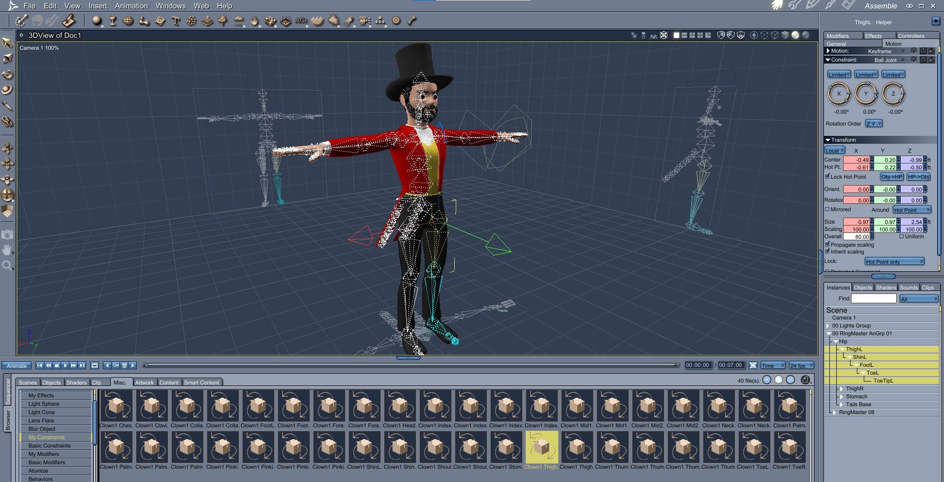

    ** Apply Clown Joint Constraints and NLA to RingMaster  **
    Recall that my circus models start from a few bases, along with matching bone skeletons.  Sort of like my own Genesis Male, Female, and Kid.  The Fat Clown and the RingMaster are derived from the same base.  Here I applied the constraints from the clown to the RingMaster and applied the same NLA clip for a running pose.  Appears to be off to a good start.  Something strange happened to the left eye, so I better check to see if I inadvertantly attached that eye to the skeleton instead of parenting.  Overall, I'd say the saved joint constraints worked out OK.  Should save a lot of time for the constraints/rigging of the other characters.

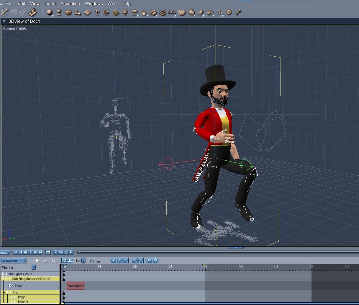

    - PIC 1 - Ringmaster Figure loaded in scene.  Thigh selected, notice no constraints yet in upper right properties tray.
    - PIC 2 - Figure after dragging and dropping the ThighL constraint from the browser tray to the Constraint tab in the Properties Tray.  See rotation order, ball joint and limits all load.
    - PIC 3 - Apply same clown running pose that was saved as NLA clip to the sequencer for the RingMaster.  Adopts running pose.
    ee01 RingMaster figure loaded and thigh selected misc browser open to my constraints.jpg
    1907 x 971 - 426K
    1918 x 979 - 442K
    1217 x 1033 - 216K

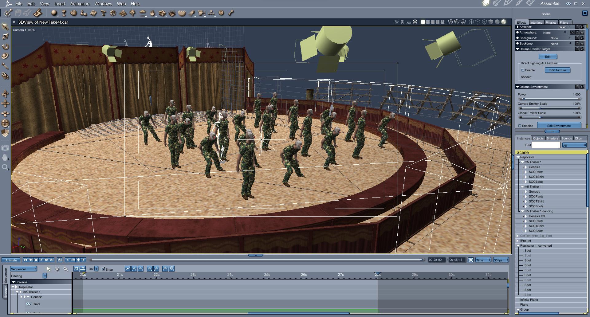

    Philemo_Carrara said:
    First wip: first half of the animation
    Main animation is scary clown walk and Thriller 1 from Mixamo
    Public has some sitting animation also from mixamo
    Octane is used to render
    Animation of the dance needs to be redone (hands entering body, for instance, which can be handled with the arm space parameter in mixamo).
    Characters are organized with "regular" replicator. Grid for the dancers, circle for the spectators.
    I'll be on the road next week, so don't expect any improvement before 2 weeks :-)
    circus tent and stuff are from the carnival products here in Daz.

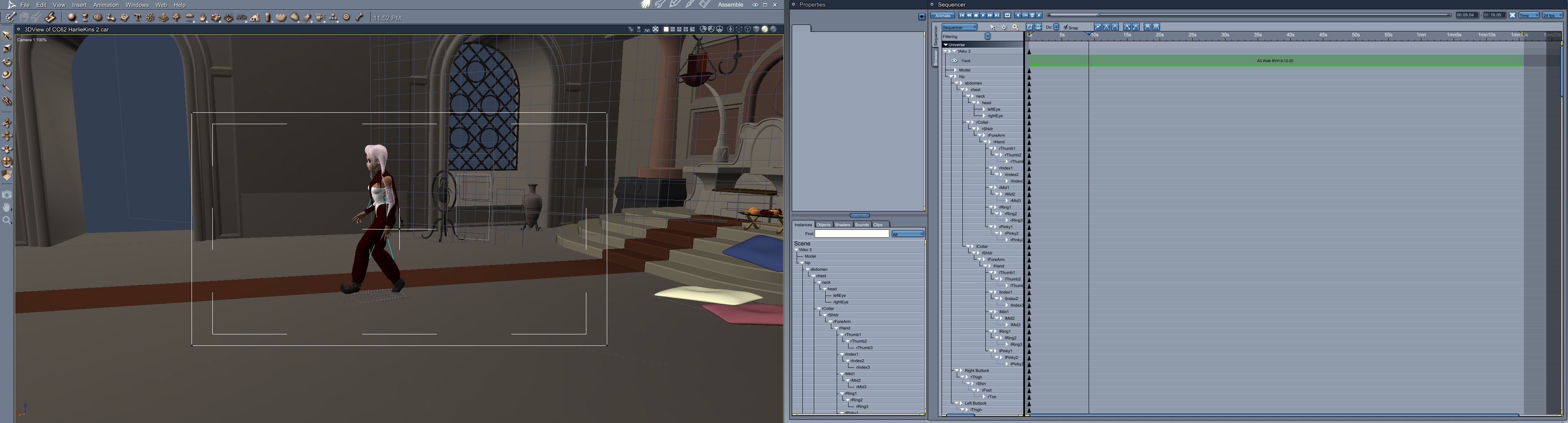

    Carrara setup:
    Carrara setup for first wip

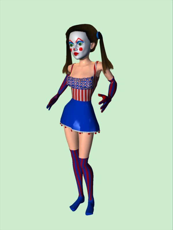

    Adding a female clown.
    Screengrabs attached of modeling the costume in the vertex modeler after detaching the mesh from the generic skeleton, painting the face using Carrara's 3D paint tool, posing the figure using the IK target helpers, and a test render.  The hair is 3 pieces.  The main hair is grown on the generic hair cap.  I used the brush tool to pull the hair towards the sides.  I then modeled two cylinders to grow the pigtails from.  Not sure I am satisfied with the hair.  My next task, and my first entry, will be trying to animate a short dance routine with the 3 clowns.
    1887 x 999 - 243K
    1197 x 973 - 129K
    1460 x 934 - 246K
    600 x 800 - 27K

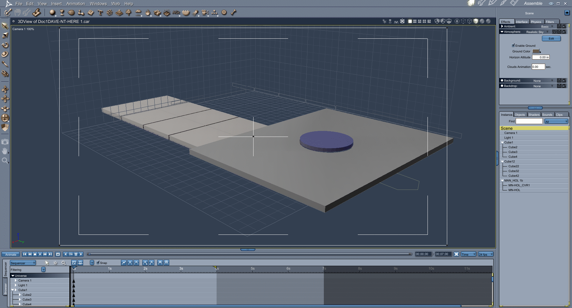

  • ed3Ded3D Posts: 2,358
    edited May 2022
    ~  and then ~
    1920 x 1035 - 239K
    Post edited by ed3D on

  • DiomedeDiomede Posts: 15,264
    edited May 2022
    Sorry for appearing not to acknowledge some recent comments or reply to recent issues.  I wrote a long post which got boinked by the forum hiccups.
    Request for Info
    How do you get a keyframed animated figure to follow a motion path?  I have been working on a walk cycle for my fat clown.  Mixed results so far, but making progress.  I see there are motion paths, but that is a different animation setting from keyframe.  So I thought I would get around that by inserting a target helper, moving the target helper along the motion path, and then parenting the figure to the target helper.  Instead my walking clown loses it walk cycle when parented in this way.  Not sure what is going on.  The alternative of keyframing each step doesn't seem correct.  The dark recesses of my mind remember a walk cycle motion path tutorial, but I think that was for Dork and Posette in Poser 4.  The manual (Carrara 7) did not not clear it up for me, but I could be looking in the wrong place.  I got some good tips from a Carrara 5 Pro Handbook (Chapter 15) on walk cycles in general, but the example of forward movement did not use a motion path.
    2512 x 1401 - 807K
    Post edited by Diomede on
