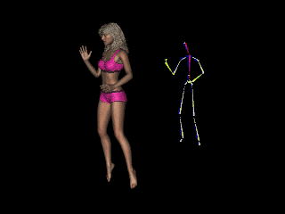

    so today i will make the figure posing more intelligent
    for example, forbid foreArm side-side rotation
    and probably the shin side-side rotation
    maybe i'll borrow some of my mcjAutoLimb code for this

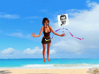

    fig 2 that's more like it !
    there's still minimal side-side rotations on the arms but i'll leave it like that for now
    at least the arm is not over-twisted anymore
    issue which will be fixed: figure is positioned 154 cm too high

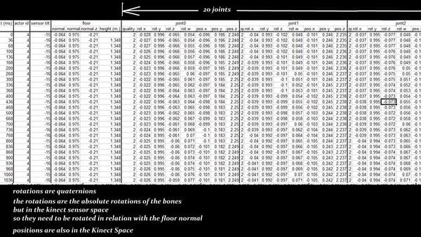

    figure 3 for the benefit of anyone wanting to write their own Client
    the format of the mocap .txt files

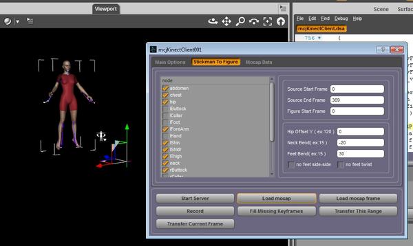

    progress report

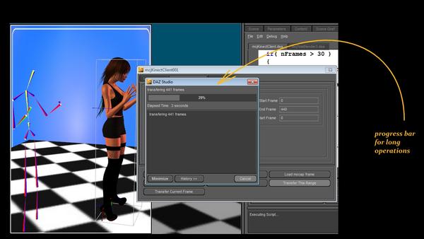

    done
    - (hopefully) fixed the over-twisted left arm issue
    - progress bar during long operations with the possibility of interrupting it
    - warns user if no figure is selected
    todo
    - bend-offset on the feet and neck
    - warn user that locked bones or limits may interfere with poses
    - test with
    - Norm toony ( the zero-posed arms differ from the norm ),
    - TheGirl ( zero-posed legs differ from the norm )
    - Victoria 4
    - Genesis

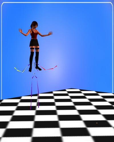

  • mCasualmCasual Posts: 4,607
    edited February 2015

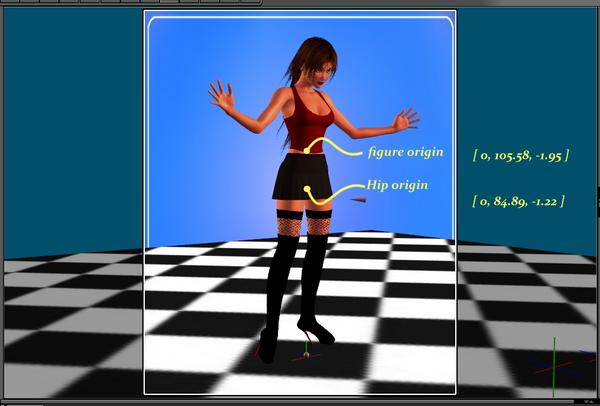

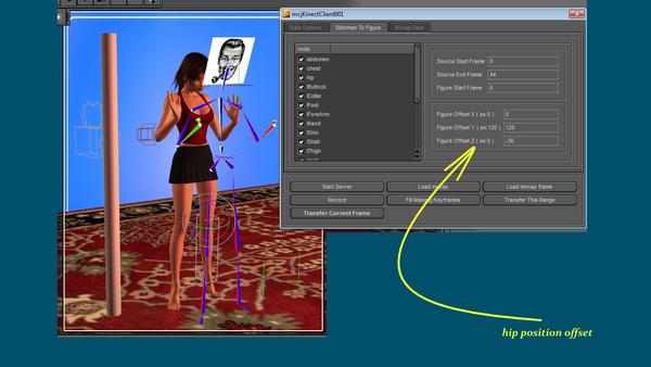

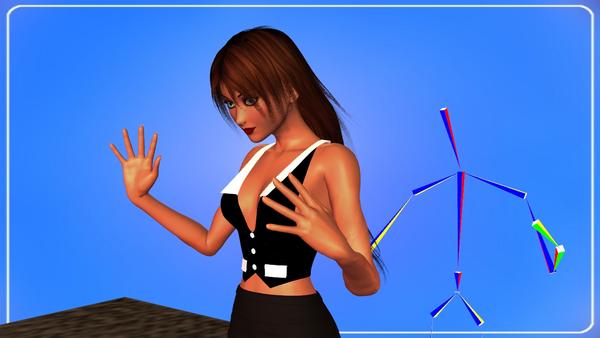

    little problem here Aiko's root bone is about at the same location as Aiko's hip bone
    so that will be fixed somehow in the official 001 release
    in the meantime, you could move the root bone approximately 144 cm down along the Y Axis before transfering the pose(s)
    Fig 2, Fig3 - the official release will include an "offset" to tweak the figure's hip position

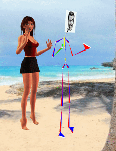

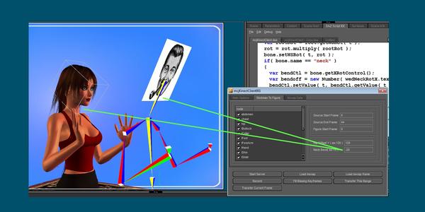

    Fig 4 - Neck Bend adjustment because the kinect's skeleton's neck is always bent forth

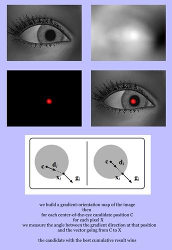

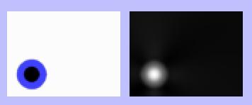

    http://www.inb.uni-luebeck.de/publikationen/pdfs/TiBa11b.pdf
    that's a German university paper about gaze / iris tracking
    i may use this method to add eye tracking to the kinect's head/face tracker
    here you can see the X and Y gradients of the image
    ( i actually used a daz script to test this ! but this will be done in the KinectServer, way faster )
    and someone here implemented it https://www.youtube.com/watch?v=aGmGyFLQAFM

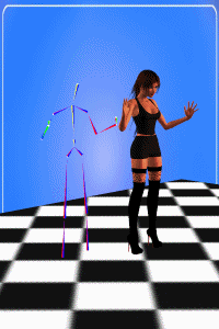

    i did a quick non-seated test and it seems to work
    note that i normally check-mark the server's "delayed" check-box,
    so when the capture really starts i'm fully in view
