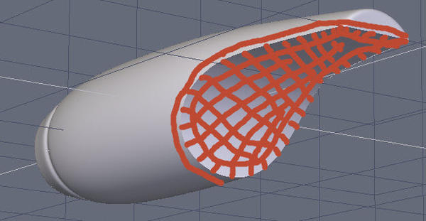

    Edit to add pic ... very rough draft of where the tess lines need to be. Working from a Boolean cut though tends to result in an unusable file.
    625 x 324 - 50K

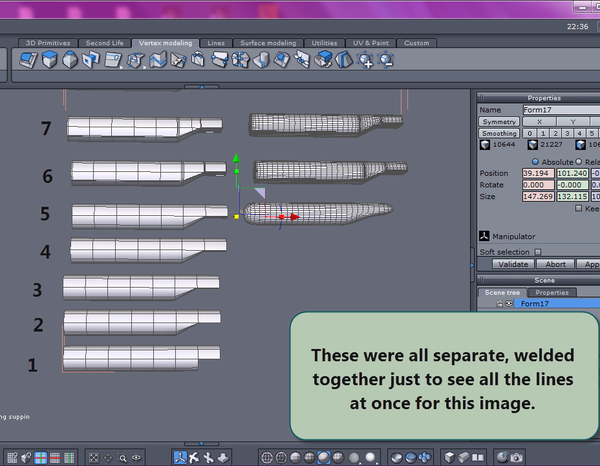

    okay ... I've sent you a PM with a link to the object file for your amusement.
    928 x 721 - 140K

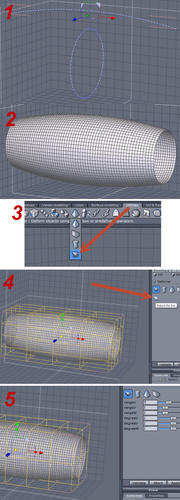

    Hi,
    If you want to get good poly_flow, you can go with sub_d. but, IMHO, you would be better to go with the cage_deformer.
    A very quick example.
    1. Created a 3_point_arc and a circle
    2. With arc selected. Use "Surface modeling > Sweep surface" and sweep around the circle. Collapse any Dynamic_geometry.
    3. With base shape selected. Select "Utilities > cage_deformer.
    4. You will then see the default cage appear around the selected object. In the properties, you can click on the little icon to edit the cage (Adjust the box)
    5. Change settings as required.
    NOTE: The "Range" allows you to set how many divisions are along each axis of the cage_deformer. The "degree" sets how smooth the transition is between those divisions.
    Once the Cage is set. Click on the cage icon again, so you can start deforming the object.
    6. You can LMB select any of the points/vertex of the cage_deformer, or use the RMB+drag to select. Here I have selected the bottom right set of points on the cage.
    7. With the manipulator, move (or scale / rotate) the select cage_points.
    8. Keep selecting / adjusting as required.
    9. Once done, select "Apply" in the properties.
    As I said, it is a very quick example, but it is an option to try.
    633 x 1191 - 323K
    573 x 1593 - 300K
