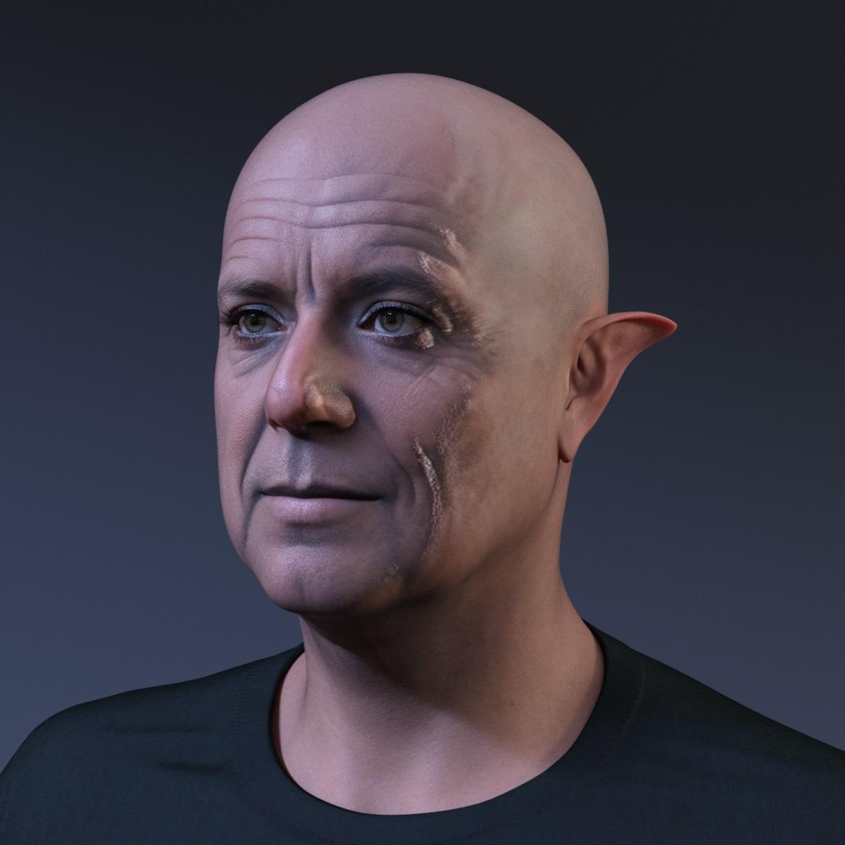

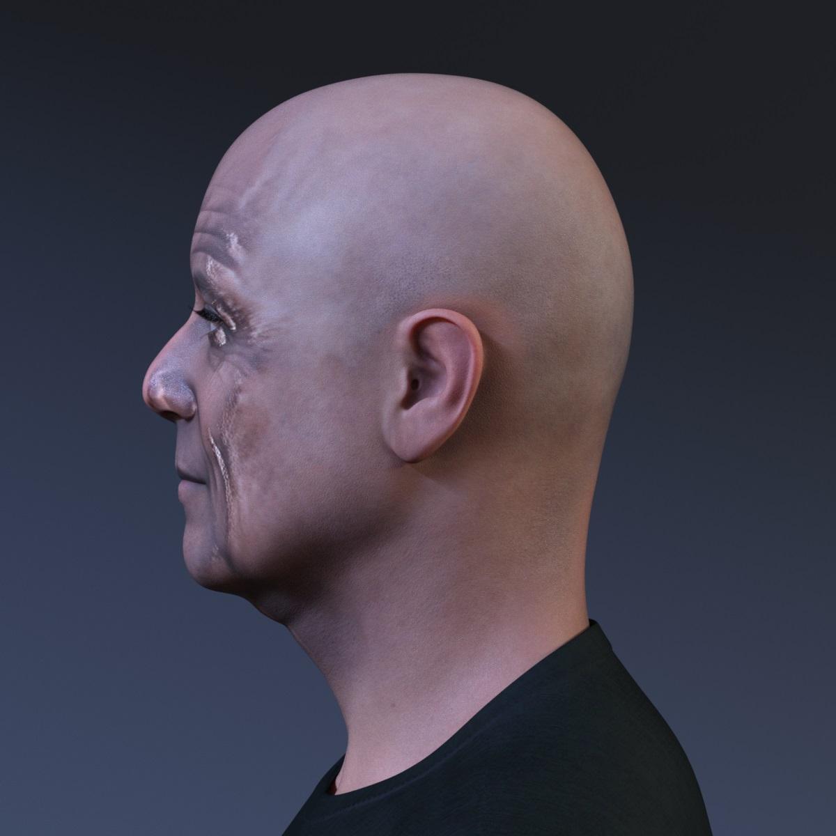

    Example render of the above character after playing with the left ear morphs.
    1200 x 1200 - 199K
    Post edited by Artini on

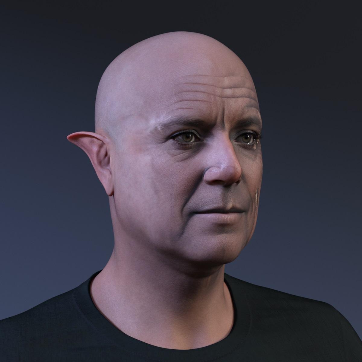

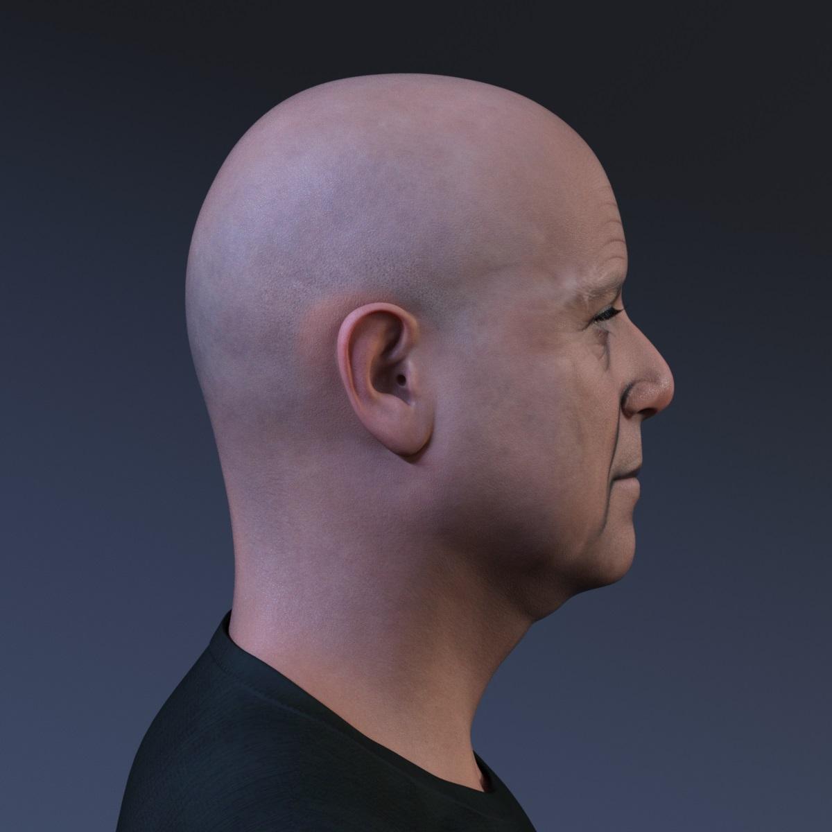

    ... and a view from the other side.
    1200 x 1200 - 195K

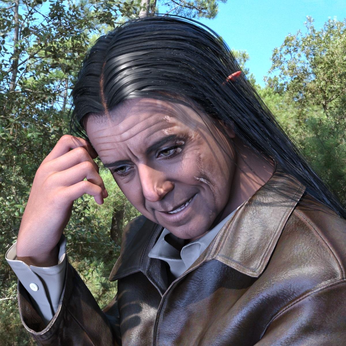

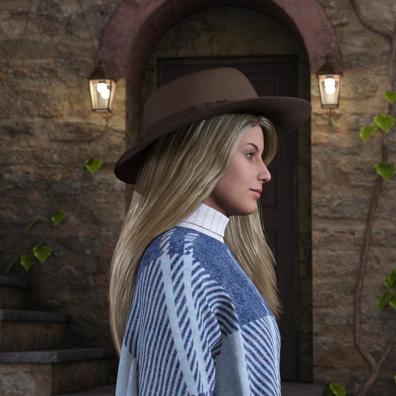

    Genesis 9 character from my previous post with converted hair from
    https://www.daz3d.com/alascanus-hair-for-genesis-8-males-with-dforce
    1200 x 1200 - 356K

    Closeup render of the above character.
    I think for me ears on the characters created with Face Transfer 2 are not a big deal,
    because I rarely render bald characters in Daz Studio.
    Bigger problems are stains and discolorations of the skin on the face.

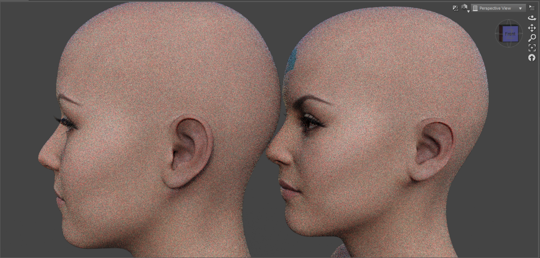

     You can use the Shape Splitter product: Shape Splitter | Daz 3D, to create a "negative morph" of the Ears only from the Face Transfer morph to effectively take out the unwanted huge ear hole deformation that always seems to occur. Example attached. The right figure is the base FT2 morph and deformed ear, left is basically back to the baseline G9 ear after applying the negative morph. Takes a little practice to get used to the tool, but I use it all the time to cut up and combine morphs, this only took less than 2 minutes to accomplish. TD

  • I have that tool. I had forgotten all about it. If I'm not mistaken you have to place the plane in the right place to do the necessary "splicing". Mainly because I don't think the basic functions deal with ears.
  • There is a tab called "Regions", this has an "Ears" selection only available. I may or may not use the calculate function to correct the location, you can make two morphs quickly, one with corrections or one without. then go to the created morphs and either turn off the limits, or modify them so "-100" is availabe, now you can trim out the FT2 ears as desired. TD
  • I played with it last night using the cutting plane and it worked pretty well. I also saw that there was a weight map option. I think I might play with that and see if it takes less steps. There was an example on the product page about using weight maps to isolate a nose morph.

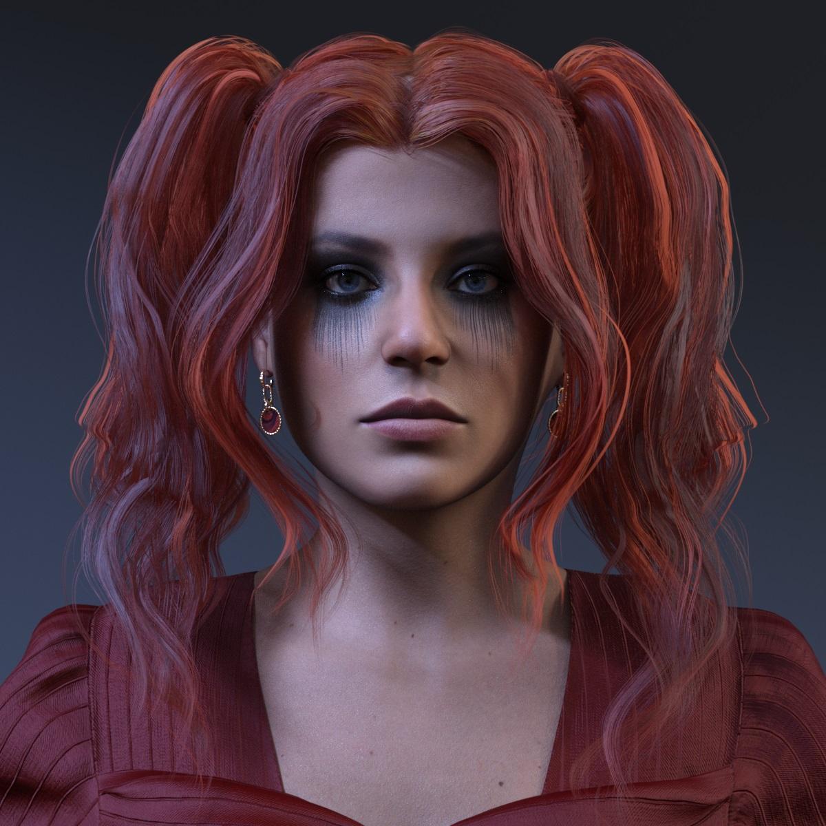

    Just playing with some new products and one of my random Face Transfer characters.

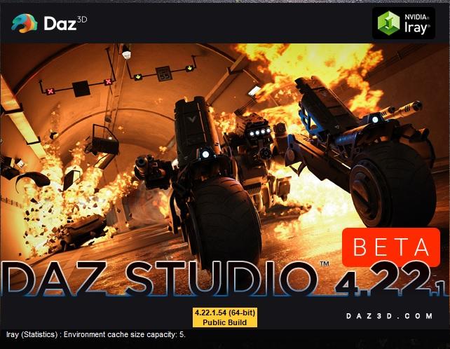

    I am glad to confirm that new Daz Studio beta (4.22.1.54)
    still works on my computer with Face Transfer 2.

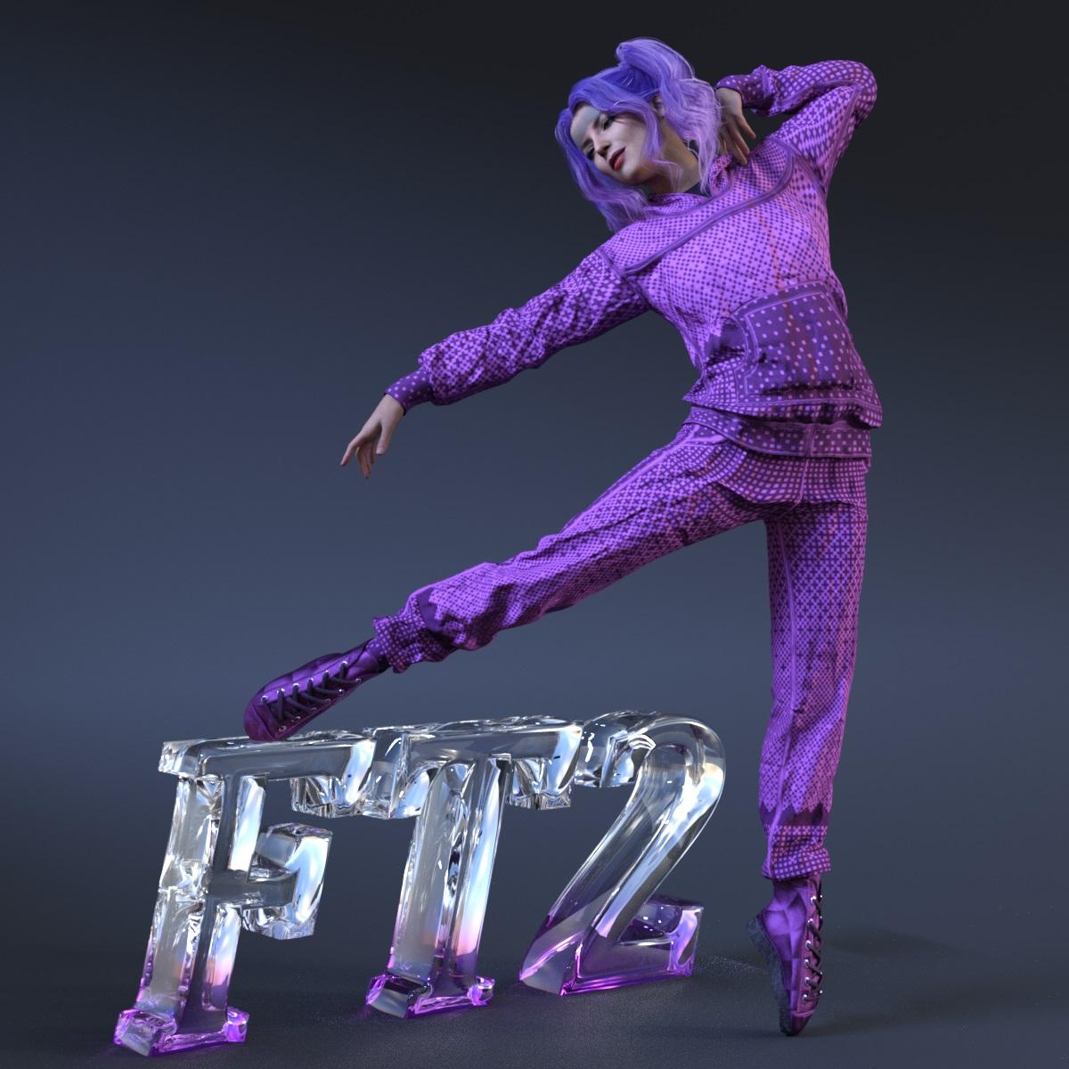

    Face Transfer 2 rocks...
