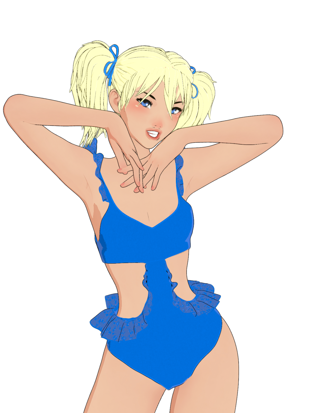

With an anime theme, I had to make some Kaiju action! I took Olympa 9 and turned her into an anime character! 60% anime head, 100% Olympia. Had some fun with some old assets I haven't used in a while, and added the Filatoon shader to everything!
Edit: Easier to attach them, images weren't resizing and added two more with a different color, the original clashed too much with the scenary.

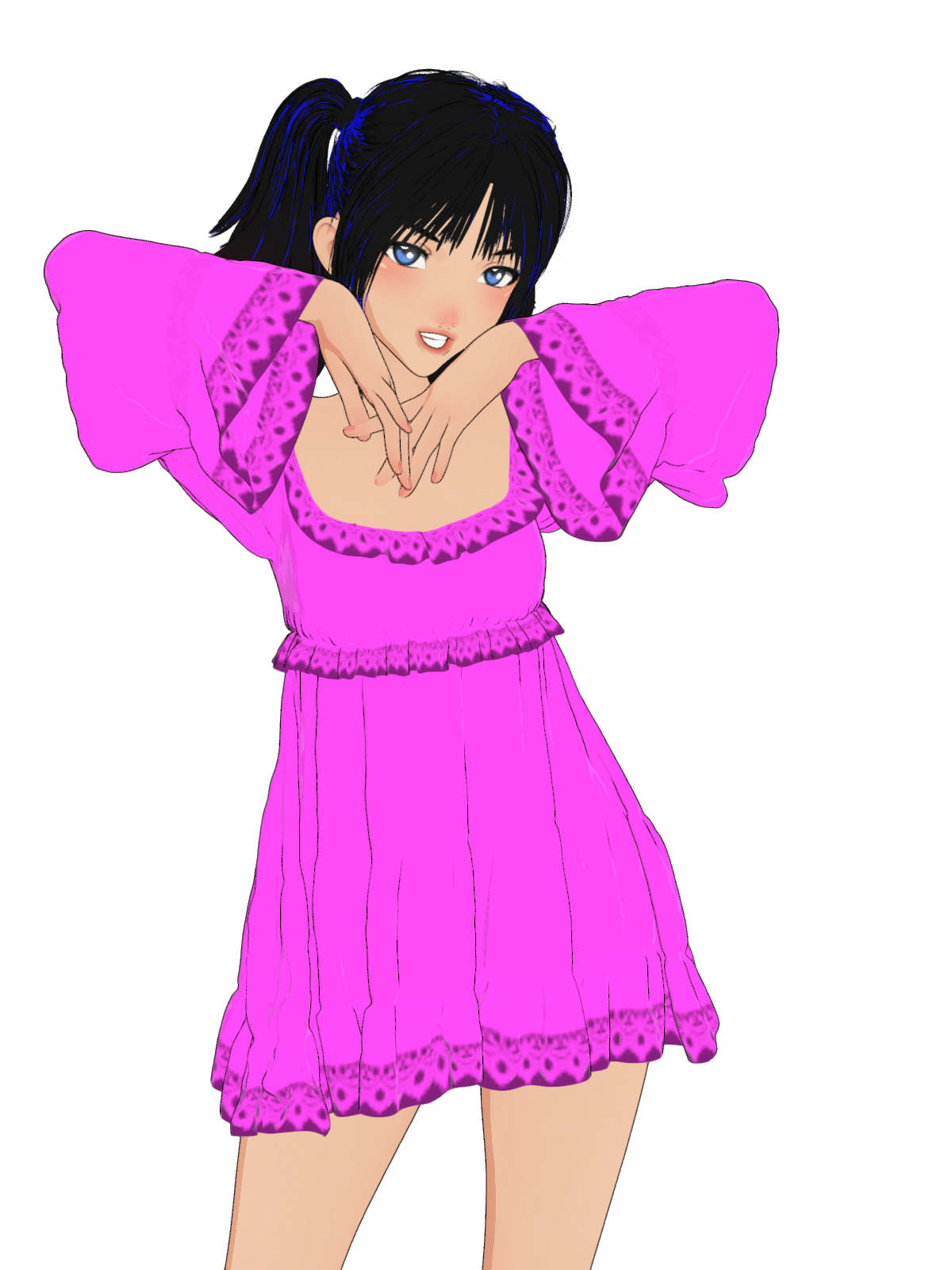

Having fun playing with this. Here's my first attempt. Still haven't figured out how to get rim lighting to work though. First one is base anime toon with a little Ally 9 and second has more Ally 9 with 50% base anime toon with different eye morphs. You don't really need to buy the new bundle, everything you need is there free to play with but I will anyway.
Ugh, I can no longer add photos on my iPad! I will come back and add on the computer.
Now I'm going to actually watch the video and PDF lol. Anyway, this seems like a good version of "Aiko 9."
@Wonderland
Nice work :) Look for Rim Lighting on the shader - you actually have a lot of control on how bright, colour etc - pretty fun to play around with.

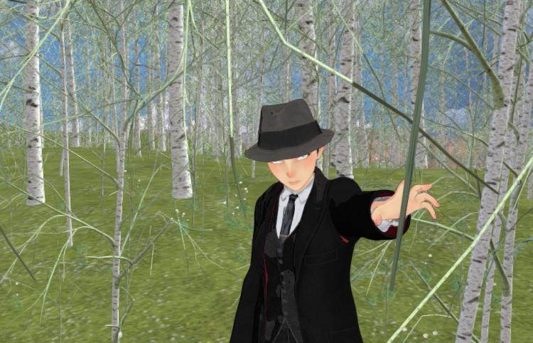

Is thyere a way to change the shaders of elements in UltraScenery 2. I could change the ground. But I don't see a way to change the trees, foliage, etc.
I can't find the whole product in smart content. It's in the content library but when I search for toon or anime in smart content, it doesn't show up....
You need to be able to select geometry to apply the shader, if there's no geometry to select (because of instances) it won't work. I don't have Ultrascenery 2 but hopefully someone else will have a workaround or a definite no :)
Reimporting Metadata would be my first step to see if that helps it to show up :)

@MarcCCTx - If you only want a few trees/plants etc, you can find the models in "Landscape>Environment" (in Content Library). I think some are under USC folder and you'll find others in folders with "Botanicals" in the name - Seems you would be able to use those with the toon shader. You might also try adding a model to a scene, adding the shader bits and pieces to it (Geoshell etc) and then creating instances of it (worth a shot, don't know if it'll work). If it does, and you have it, using Ultrascatter would then get you a toon forest pretty quick
