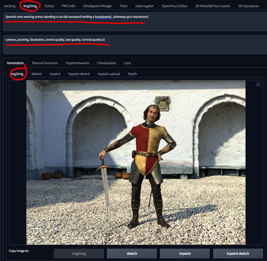

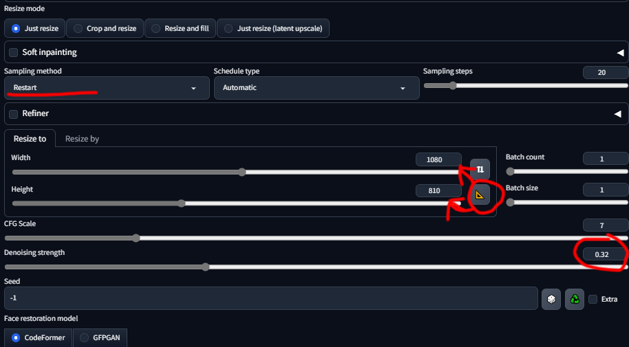

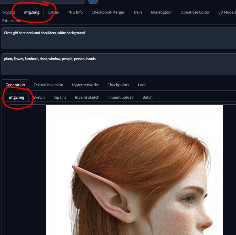

Image Generation with Img2Img
  1. Switch to the Img2Img tab.
  2. Upload the DAZ image you want to modify in the image input section.
  3. Configure the following settings:
    • Sampling Method: Use Restart (my recommended method).
    • Schedule Type: Use Automatic (if not available, select Karras).
    • Sampling Steps: Set between 33 and 40.

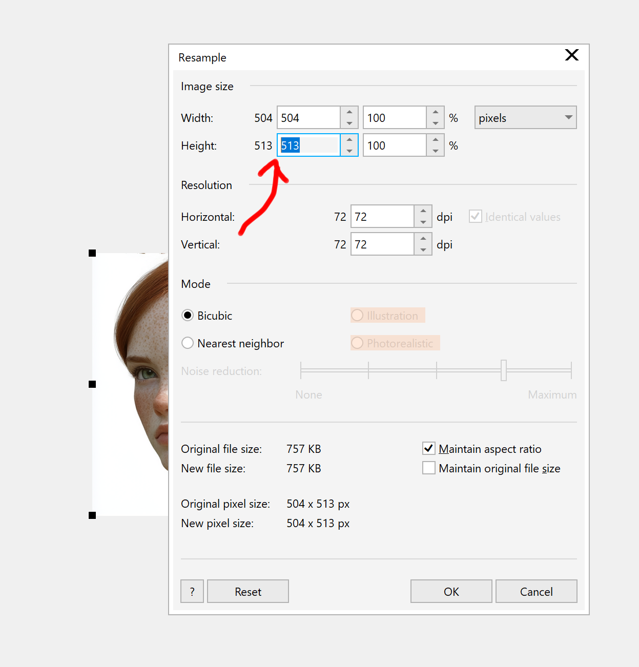

  4. Go to the Resize tab and click the yellow triangle icon to resize your image. If your image is larger than 1440px in width or height, scale it down to that or lower.
  5. Set the CFG Scale between 6 and 8 (for now, you can leave it at 7).
  6. Denoising Strength is key — start with 0.4 and adjust based on the results.
  7. Set the Seed to -1 for random seed generation.
Finally, hit Generate and see what you get!

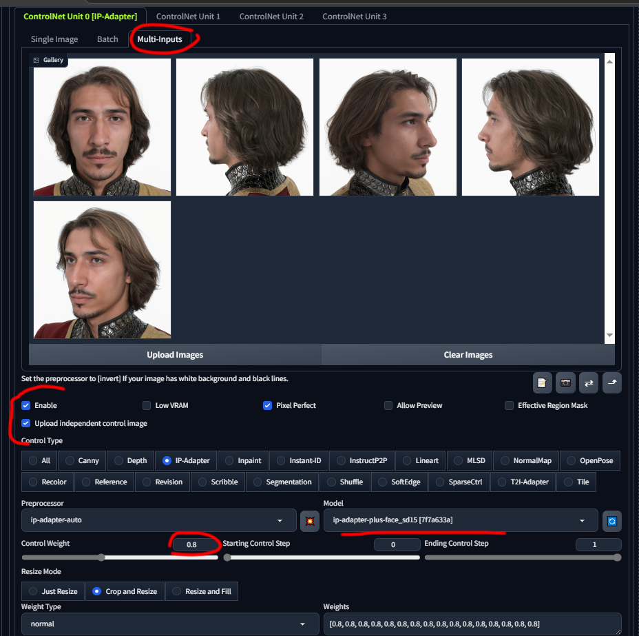

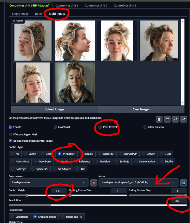

    ControlNet Setup
    1. Open the ControlNet accordion tab.
    2. In ControlNet Unit 0, check Enable.
    3. Select IP-Adapter.
    4. From the model dropdown, choose either:
      • ip-adapter-faceid-plusv2_sd15, or
      • my preferred ip-adapter-plus-face_sd15.
    5. The preprocessor should automatically update to ip-adapter-auto.
    6. Set the Control Weight slider to around 0.6.
    7. Check Pixel Perfect (this will remove your resolution slider, and I will need to do a full page guide and explanation on what this is and why later as pixel perfect is not always the best, but for now lets say it is)
    8. Check Upload Independent Control Image.
    If you only have one control image, you can upload it now. For best results, select Multi-Images if you have a profile set of different face angles. Add them if available.
    (I'll go over in the next post on ways to create profile packages like this)
    Click Generate to see the results.

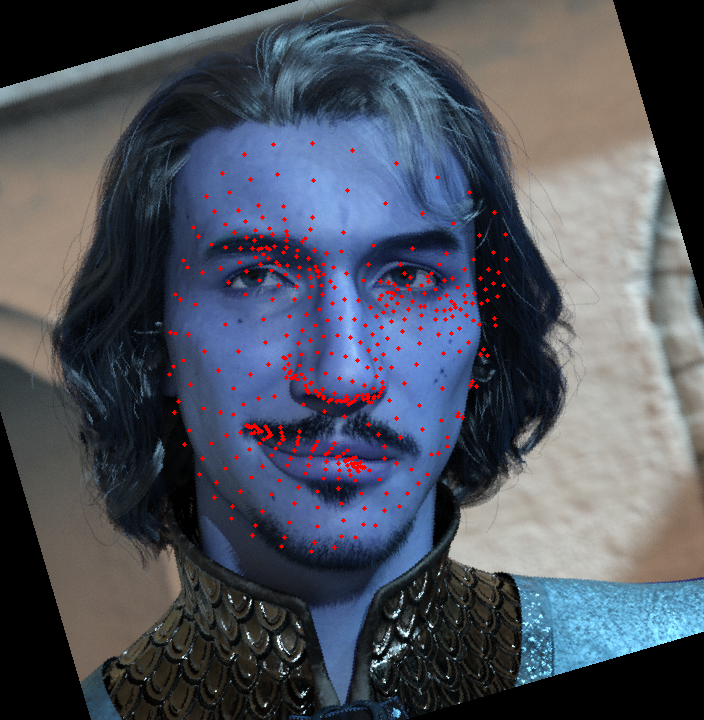

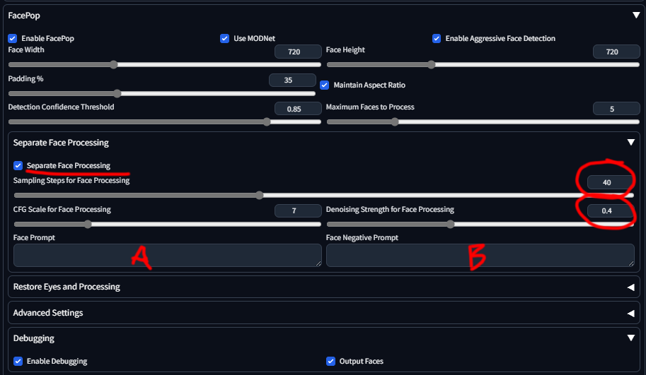

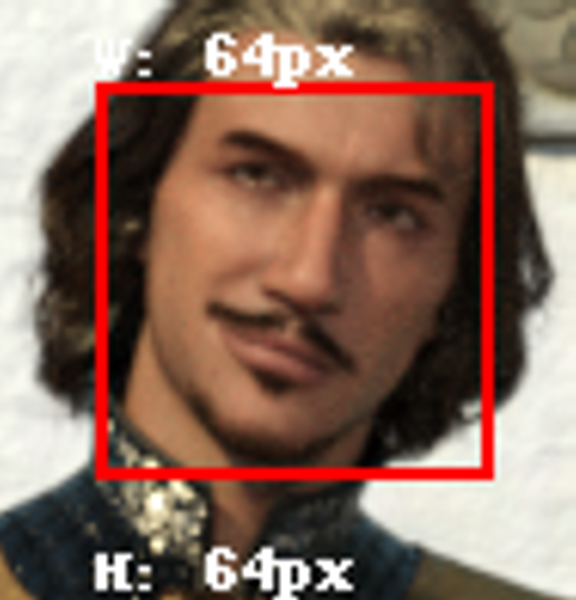

    FacePop (Optional)
    https://github.com/TheCodeSlinger/FacePop
    If you installed FacePop, enable it from its accordion tab. That’s all you need to do, but if you want to explore the masks and tweaks FacePop applies, check Enable Debugging. In your output folder, you'll find a subfolder called Debugging with useful images like landmark detections, mask creations, head orientation corrections, and final overlays before processing.
    Note: The final FacePop image might not appear inside the WebUI. Instead, check the folder where the images are generated. I use a timestamp-based naming system instead of the typical seed and image count naming. Also, metadata reproduction in FacePop images isn’t fully implemented yet, but that should come in version 1.3.

    3. FacePop: Aligns and scales the face for optimal processing.

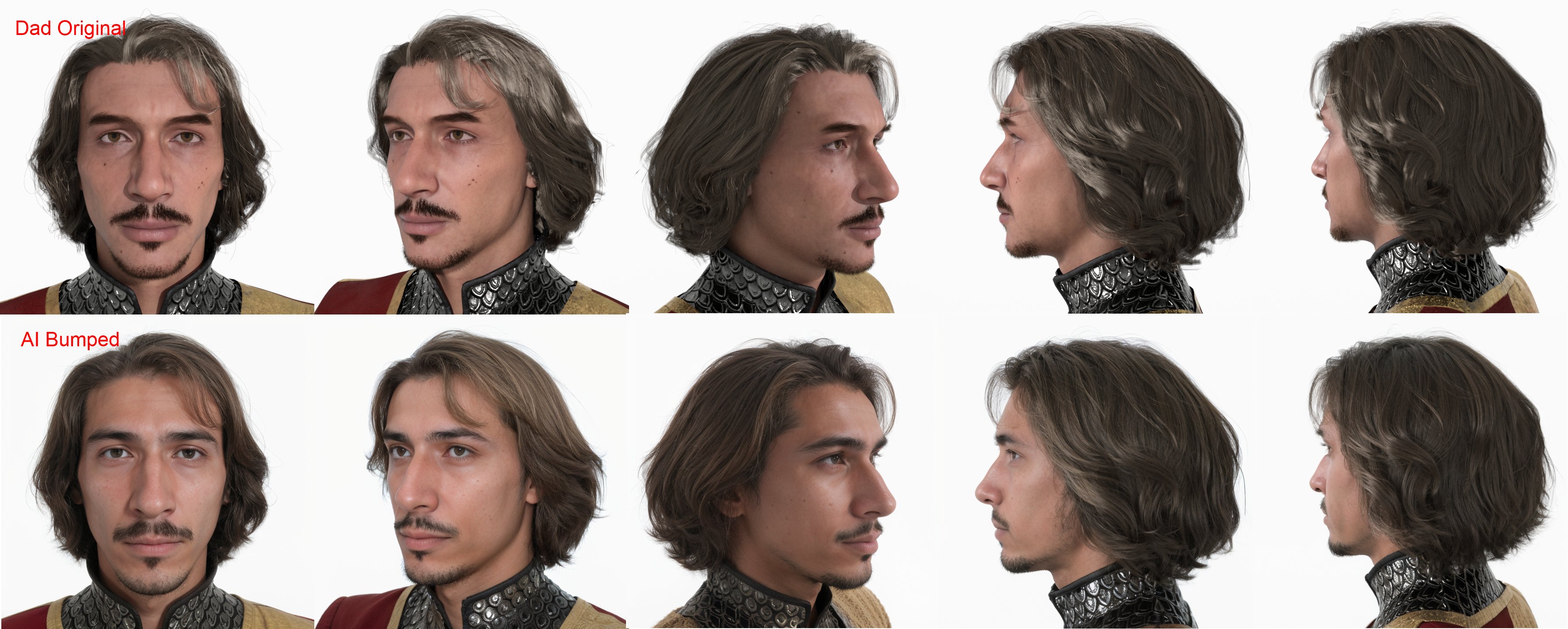

  • charlescharles Posts: 861
    edited October 2024
    Character Profile Package
    A character profile package is a collection of detailed images of your character that are used during the AI image generation process. This helps guide the AI more accurately. This technique is similar to face swapping or deep fakes, but with better accuracy because you'll have a more complete package of profile and angled shots of the character.
    There are several ways to create such a package—whether by using images from MidJourney (which I used for the profile of the woman in the example), real photos of a person, or software like DAZ 3D.

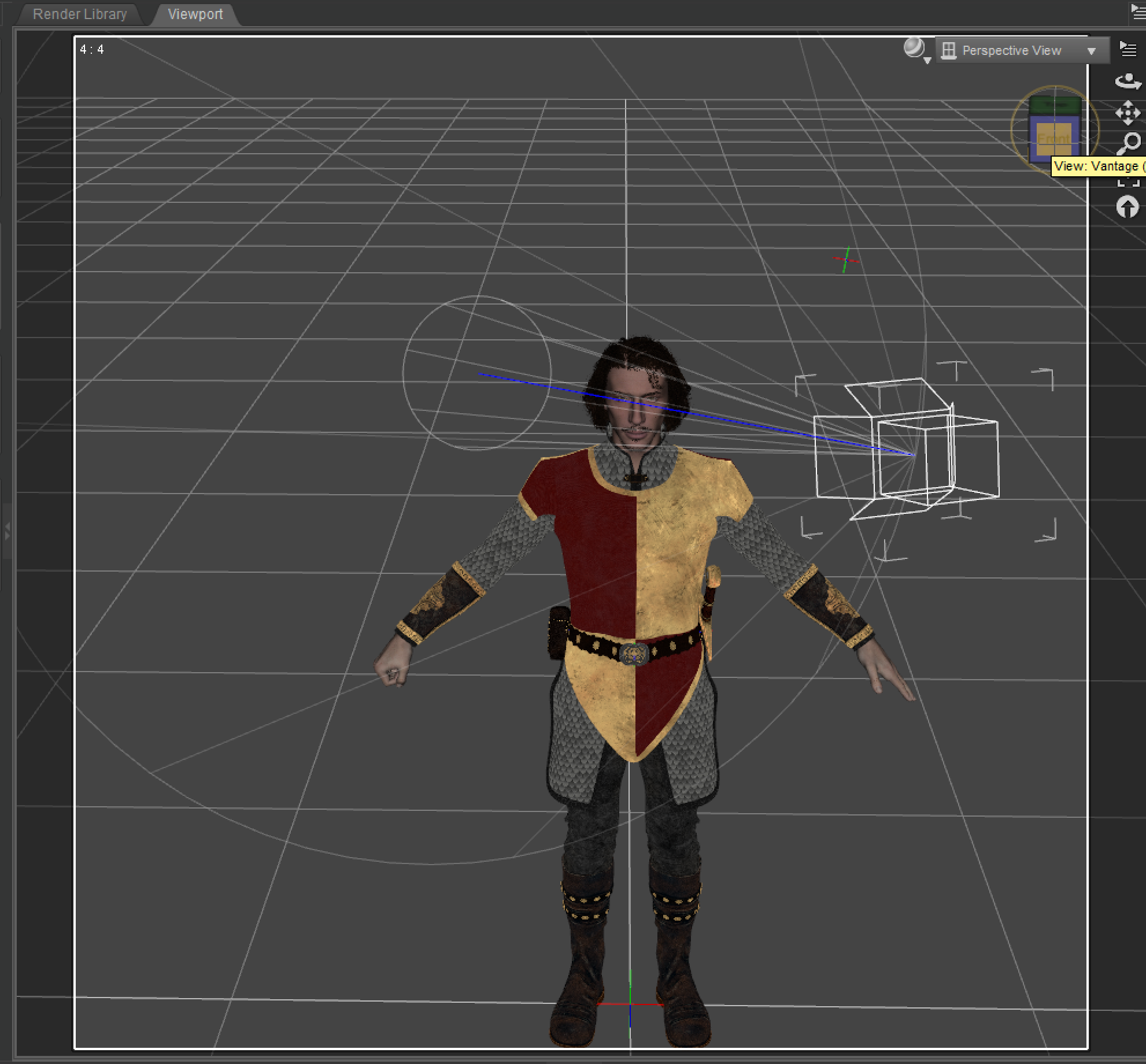

    Building a Character Package with DAZ 3D
    For this example, we’ll use DAZ 3D to create a character profile package. DAZ offers great control over character positioning, cameras, and lighting, allowing you to render precise profile and angle shots. You can customize your characters using a wide variety of pre-designed characters and morphs, giving you flexibility in creating your ideal character quickly.
    Here’s a quick step-by-step guide to building your character package:
    1. Set Up Your Character
    For this example, I'll use KOO Clyde G9 as the base character, with Qinfen Hair for Genesis 9 and Padded Armor as the outfit. Let's call this character Manuel.
    2. Choose a Well-Lit Environment
    I recommend using a well-lit HDRI environment, such as the “Almost White” set from Render Studio.
    3. Adjust Render Settings
    In the render settings:
    • Set the size to 720x720 pixels.
    • Create a basic camera for rendering.
    Note: The most common camera type used by Stable Diffusion and many AI models is 50mm, but in DAZ, I suggest leaving the default camera settings. The reason is that with close-ups, the 50mm lens might distort the face, and a 35mm lens can cause too much skew. The default DAZ camera settings seem to work best for this method. However, feel free to experiment with other settings to see what works best for your character.
    4. Position the Camera
    • Move the camera to face the character directly, head-on.
    • Frame the face, leaving about 10% margin from the top of the head and the bottom of the chin, with about 20% margin on the sides.
    • Include some of the neck and shoulders, but don’t crop the top or back of the head. Keeping the full head in the frame ensures the AI’s detection system doesn’t get confused.
    5. Lighting
    Disable the camera’s default headlamp as it can create unwanted lighting effects. Instead:
    • Create a Spotlight and set its Luminous Flux (Lumen) to around 20,000.
    • Position the spotlight just in front of the character, slightly above and to the right, angled towards the face.
    6. Additional Camera Angles
    Create additional cameras to capture profile shots from various angles:
    • Profile view: Directly from one side.
    • Angled shots: Capture 30° and 45° angles.
    • Over the shoulder: A shot from behind.
    7. Render Your Shots
    Render each shot with these cameras. Once rendered, you now have a solid character profile package.

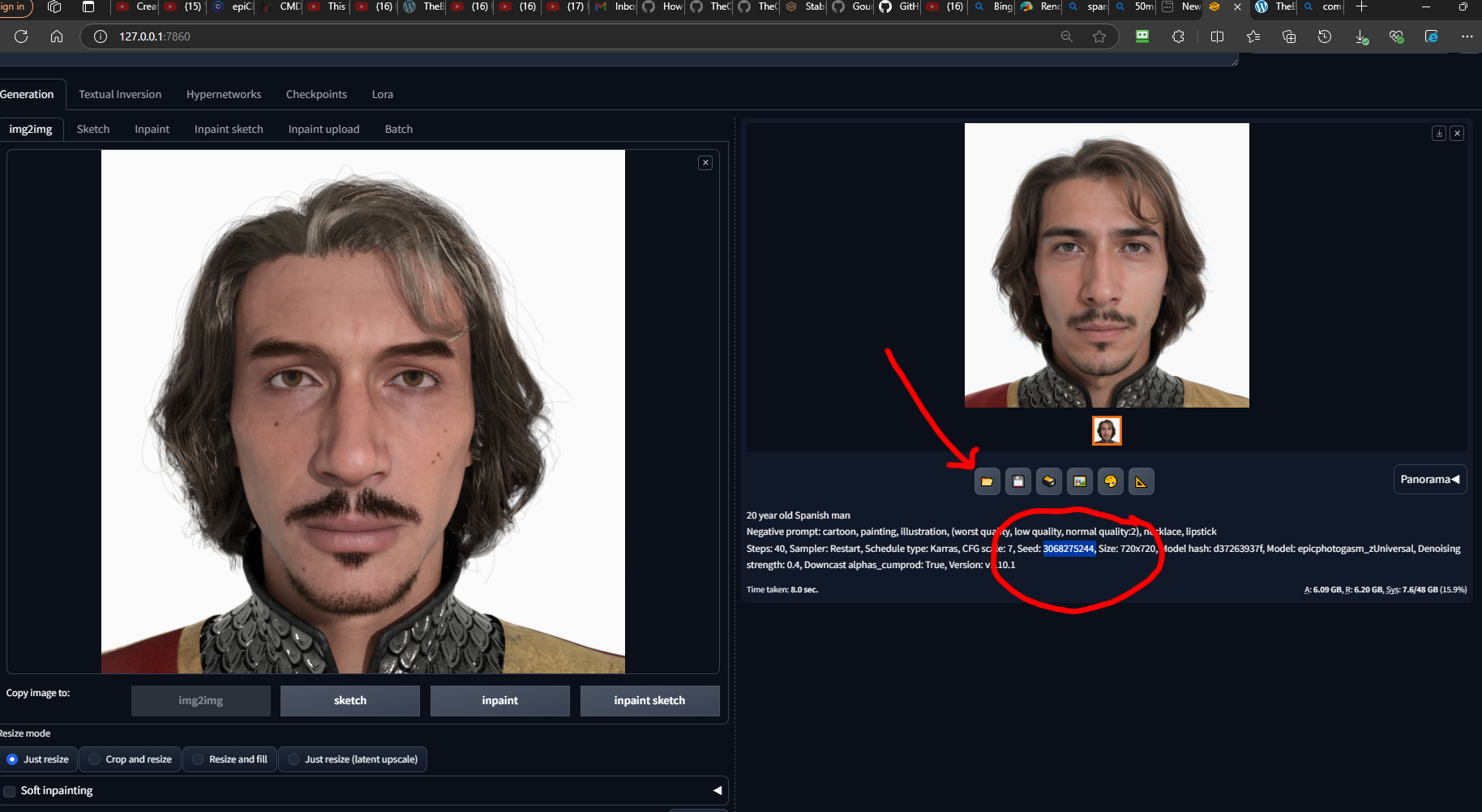

    Bringing the Images into Stable Diffusion (Automatic1111’s WebUI)
    Now that we have the profile images, we can use Automatic1111’s Stable Diffusion WebUI to refine and enhance them.
    1. Load the Model
    Ensure the model you want to use is loaded. For this example, I'm using “epicphotogasm_zUniversal”.
    2. Open the Img2Img Tab
    1. Load the frontal image you rendered in DAZ into the Img2Img tab.
    2. Add a prompt like: 20-year-old Spanish man
    Note: It's essential to include agegender, and ethnicity to help guide the AI. Most models default to young, white, brunette women, so this added detail is crucial for accurate character generation.
    Tip: You can include a name in the prompt (e.g., "Manuel Sanchez") to help guide the AI towards consistency. However, if the name is tied to a well-known individual in the dataset, the output might drift towards that person’s likeness, so use this tactic with caution.
    3. Add a Negative Prompt
    In the Negative Prompt field, include the following:
    cartoon, painting, illustration, (worst quality, low quality, normal quality:2), necklace, lipstick
    This helps to avoid unwanted artifacts such as cartoonish effects or unnecessary accessories.
    4. Adjust Settings
    • Sampling Steps: Set to around 40.
    • Sampling Method: Select Restart.
    • Schedule Type: If available, choose Automatic. If not, select Karras.
    • CFG Scale: Leave it at 7 for now.
    • Denoising Strength: Start at 0.32 to 0.4. A lower setting keeps the image close to the original, while a higher setting introduces more realism. Adjust based on your preference.
    Once you’re satisfied with the results, copy the seed from the information below the preview image. You can also review previous renders by clicking the folder icon under the preview.
    Tip: You can drag any image back into the image box and click PNG Info to retrieve its seed and settings for consistent results.
    5. Apply Img2Img to Other Angles
    Using the same settings, process the other profile and angle shots. You may need to adjust the denoising strength for the side or over-the-shoulder shots.
    6. Fine-Tune the Details
    If your character has additional features (e.g., a goatee or facial hair), make sure to mention them in your prompt. For example:
    Prompt: "20-year-old Spanish man, goatee"
    Add any relevant exclusions to the Negative Prompt, like:
    cartoon, painting, illustration, (worst quality, low quality, normal quality:2), necklace, lipstick, beard
    Dealing with Minor Details (Freckles, Moles, etc.)
    If minor details like freckles or moles get lost in the AI’s process, it’s challenging to recover them fully at this stage. The AI often treats these as noise and ignores them. However, in a future post, I’ll discuss how to use post-processing and advanced layering to bring back these small but important details.

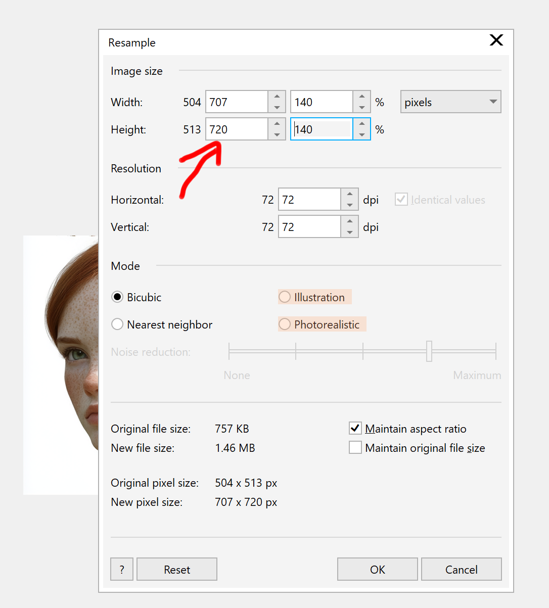

    2. Resize the Image:
      • If the image is too small or too large, resize it to a size between 720x720 and 1024x1024. It doesn't need to be a perfect square, but try to keep it close to square dimensions.

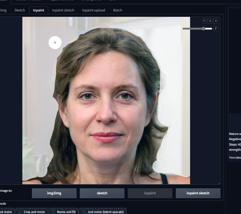

    Further Touchup with Inpainting
    Now that we’ve outpainted the image, we have an issue with earrings—they don't match and it would be better if the character had none. Here’s how to remove them using Inpainting:
    1. Inpainting Setup:
      • Set the script dropdown back to None (we’re done with outpainting).
      • Drag the outpainted image into the main Img2Img box.
      • Click the Inpaint button below the image to switch to the Inpainting tab.
    2. Mask the Area:
      • In the top-right corner of the image box, you’ll see a slider that adjusts the brush size.
      • Paint over the earrings with the brush to mark the areas you want to modify.
    3. Add the Prompt:
      • Prompt: "Mature woman ears".
      • Negative Prompt: "earrings, jewelry".
    4. Adjust Settings:
      • Set Sampling Steps to 40 and CFG Scale to 7.
      • Set the Denoising Strength to around 0.6, then click Generate.
    Repeat as needed to get the desired result. If the earrings don’t disappear, increase the Denoising Strength until they are removed.

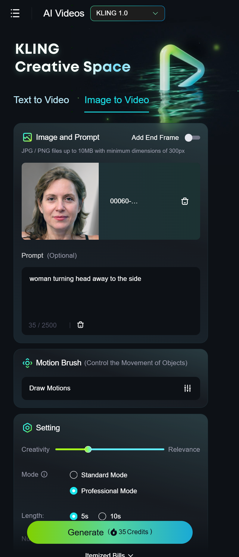

    Once You're Signed Up and Logged Into Kling (or Another Platform)
    Now that the image is prepared, here’s how to create a character profile using platforms like Kling AI or HailuoAI:
    1. Switch to Image-to-Video Mode:
      Upload the ArtBreeder or processed image into the image-to-video tool.
    2. Create Prompts for Head Movement:
      Use prompts like:
      • "woman turning away"
      • "woman looks behind"
      • "woman turning to the side"
      The goal is to generate a video where the character turns their head completely or moves to the side, without blurriness.
    3. Enhance Output Quality:
      In Kling, you can upgrade to Professional Mode to generate higher-resolution videos.
    4. Adjust Creativity and Relevance:
      Adjust the Creativity/Relevance slider:
      • More Creative: Allows for more head movement but may introduce unnatural or exaggerated movements.
      • More Relevant: Restrains the creativity but may limit the range of movement.
      Results can vary, so you may need multiple attempts. HailuoAI is currently free with no processing limits, but you can only work with one image at a time, and the queue might be long.

    Now I’ll crop each headshot into individual images and resize them to around 720x720 pixels. In PhotoPaint (or your preferred software), resize the largest dimension to 720 and keep the aspect ratio locked.

    Outpainting with Stable Diffusion
    1. Drag one of the images into Stable Diffusion WebUI, under the Img2Img tab.
    2. Use this prompt:
    • <strong>Prompt:</strong> Elven girl, bare neck and shoulders, white background
    • Negative prompt: plant, flower, furniture, door, window, people, person, hands
    1. Make sure the image dimensions are correct by clicking the yellow triangle in the Resize To box.
    2. Set the Script dropdown to Poor Man’s Outpainting. Set Pixels to Expand to 48 and Mask Blur to around 8.
    3. You might need to run several attempts to get decent results. Increasing Sampling Steps to around 60+ can help.
    Repeat this process for any images that need padding or adjustments.

    1. Adjust the settings:
      • Sampling Method: Restart
      • Schedule Type: Automatic or Karras
      • Sampling Steps: 30-40
      • CFG Scale: 7
      • Denoising Strength: 0.4
    2. Make sure no other extensions are active.
    3. Using ControlNet for More Precision
    1. Open the ControlNet accordion box.
    2. On Unit 0, check Enable.
    4. Check Pixel Perfect.
    5. Check Upload Independent Control Image and upload the original photorealistic image.
    6. Preprocessor: ip-adapter auto
    7. Model: ip-adapter-faceid-plus_sd15
    8. Control Weight: Set to around 0.8.
    Click Generate.

    In the end, you should have a good collection of head angles for IPAdapter to work with:
    Note: The ears might not match the original reference exactly, but for our purposes, they are close enough.

    FacePop in Depth
    FacePop is an extension for Automatic1111's Stable Diffusion WebUI and ForgeUI that enhances AI img2img processing by tackling the challenges of facial inconsistency when characters appear at different distances and orientations within images. It employs advanced face detection to locate faces—even small or tilted ones—and then crops, upscales, and rotates them to an upright position.. By processing these faces separately and reintegrating them into the original image with masking to prevent double processing, FacePop attempts to accurately preserve consitancy of characters across various image compositions.
    Analyzing the Example Images of Manuel
    Consider three rendered images of Manuel at a resolution of 1080x810 pixels (a 4:3 ratio), each capturing him in a cocky stance with his head tilted approximately 15 degrees to his left.
    1. Close-Up Shot:
      • Face Detection Box: Approximately 494x494 pixels.
      • Description: Manuel's face occupies a significant portion of the frame, displaying detailed facial features such as skin texture, eye color, and subtle expressions.
    1. Medium Shot:
      • Face Detection Box: Approximately 165x165 pixels.
      • Description: Manuel's upper body is visible, with his face smaller in the frame. Key facial features are still discernible but less detailed.
    1. Long Shot:
      • Face Detection Box: Approximately 64x64 pixels.
      • Description: Manuel appears full-body within the scene, and his face occupies a minimal area of the image, resulting in a significant loss of facial detail.
    These images serve as practical examples to explore how varying face sizes and orientations impact the performance of AI models during img2img processing.

    Let's setup Automatic1111's Stable Diffusion Webui for doing an AI Bump using IPAdapter and our Character Profile Package of Manuel.
    You can see my configuration above. One thing to note is the denoising is set low for SD1.5 model of .32. The lower this is set the less the AI Bump will drift the final image from the original. Other models will handle denoising and CFG differently and .32 might be considered too high. Reference the information to whatever model you using for averages and recommended settings, as well as just experiement.
    Configure ControlNet with IpAdapter PlusFace and use our Character Profile Package for Manuel for guidance.
    Here is our results without FacePop
    Even though we used CN and IPAdapter the results are less than amazing or consistant of Manuel.
    Let's try this again with FacePop now active. We will also open and enable the Seperate Face Processing section. By activating we can override the default WebUI settings whe processing the face. We can specify Sampling Steps, CFG Scale, Denoising as well as a different Prompt and Negative Prompt (note: even when enabled if prompts are left blank they will use the default ones from above.)
    By default Output Faces is enalbed, which will include the face only processed image in the output folder along with the final processed image.
    Final Image
    The results are probably not so obvious with the Long Shot of the AI Bumping, except to demonstrate how using these techniques without proper scaling and alignment, you will get inconsitant and poor quality results.

    1. Impact of Face Resolution on Feature Extraction
    • Close-Up Shot (494x494 pixels):
      • High Detail Availability: The abundance of pixels allows the AI model to capture intricate facial features, enabling accurate recognition and processing.
      • Effective Convolutional Processing: Convolutional Neural Networks (CNNs) can generate detailed feature maps, leading to high-quality outputs during img2img transformations.
    • Medium Shot (165x165 pixels):
      • Moderate Detail Loss: While primary features like eyes, nose, and mouth are visible, finer details such as skin texture and subtle expressions begin to blur.
      • Reduced Feature Map Quality: CNNs receive less information, resulting in less detailed feature representations and potential degradation in output quality.
    • Long Shot (64x64 pixels):
      • Significant Detail Loss: Critical facial features merge or become indistinct. The low pixel count hampers the AI's ability to process the face accurately, often leading to poor or unrecognizable outputs.
    NOTE: Even with FacePop's upscaling of the face there is still going to be signifcant detail loss due to the abscene of information due to pixelation. The only way to really overcome this is to render the image at larger resolutions.
    2. Challenges with Face Detection and Landmark Localization
    • Close-Up Shot:
      • High Detection Accuracy: Face detection algorithms easily identify Manuel's face, and landmark localization is precise due to the high resolution.
      • Accurate Alignment: The model can align and process the face correctly, preserving Manuel's distinct features.
    • Medium Shot:
      • Reduced Detection Accuracy: The smaller face size may introduce minor errors in detecting facial landmarks, affecting alignment and potentially introducing inconsistencies in the generated image.
    • Long Shot:
      • Detection Failures: The face may fall below the minimum size threshold required by detection algorithms, leading to failure in identifying the face.
      • Incorrect Landmark Placement: Even if detected, low resolution can result in inaccurate landmark localization, causing distortions in the processed image.

    4. Information Loss Demonstrated
    • Nyquist Sampling Theorem Implications:
      • Close-Up Shot: Satisfies the sampling requirements, capturing high-frequency details essential for accurate reconstruction.
      • Long Shot: Violates sampling conditions due to insufficient pixels, resulting in aliasing and significant information loss.
    • Pixelation and Quantization Errors:
      • Long Shot: Each pixel represents a larger area, causing pixelation that obscures fine details and introduces quantization errors, which the AI may misinterpret during processing.
    Inconsistencies Observed in AI img2img Processing
    1. Variability in Generated Outputs
    • Close-Up Shot:
      • Consistent Facial Features: The AI produces a detailed and accurate representation of Manuel, maintaining consistency with his original appearance.
    • Medium Shot:
      • Slight Deviations: Minor inconsistencies may arise due to reduced detail, such as subtle changes in facial proportions or expressions.
    • Long Shot:
      • Significant Inconsistencies: The AI struggles to reconstruct Manuel's face accurately, potentially altering key features or even misrepresenting his identity.

    FacePop is a specialized tool designed to tackle the challenges of AI img2img processing when characters appear at different distances and orientations within images. It enhances the quality and consistency of facial features in generated images, ensuring characters like Manuel look accurate and recognizable across all shots. Here's how FacePop achieves this:
    1. Aggressive Face Detection
    • Comprehensive Scanning: FacePop uses an advanced face detection algorithm that aggressively scans the entire image to locate any faces, no matter how small or tilted they are.
    • Why This Matters: Traditional face detection might miss small or angled faces, especially in long shots. FacePop's method ensures that every face in the image is detected for processing.
    2. Cropping and Upscaling the Face
    • Cropping the Face: Once a face is detected, FacePop crops it out of the original image.
    • Upscaling the Face: The cropped face is then upscaled to a default size of 720x720 pixels. Users can adjust this size based on their preferences. The aspect ratio is maintained by default to avoid stretching or squashing the face.
    • Adding Padding: An additional padding is included around the face—by default, this is 35% of the 720x720 size, but users can customize this. Padding ensures that the surrounding areas (like hair or parts of the neck) are included, which helps in seamless reintegration later.
    • Why This Matters: Upscaling increases the number of pixels representing the face, providing more detail for the AI to work with. Padding ensures context is preserved around the face.
    3. Correcting Face Orientation with Mediapipe
    Note: Why blue? At this stage the extension has converted the image to OpenPose module's native format of BGR which is different than the standard RGB. The image indicates the detected rotated upright position, while the red dots indicate the faceical landmark position's original non rotated location.
    • Using Mediapipe's Landmark Detection: FacePop employs Mediapipe, a powerful tool that detects facial landmarks such as the eyes and nose.
    • Rotating to Upright Position: By analyzing the positions of the eyes and nose, FacePop calculates the angle of the head tilt. It then rotates the upscaled face so that it's upright.
    • Why This Matters: Aligning the face to an upright position simplifies the AI's task, as most models are trained on upright faces. This improves the accuracy of facial feature processing.
    4. Separate AI Processing of the Face
    • Isolated Processing: The upscaled and rotated face is processed separately through the generative AI model (like Stable Diffusion).
    • Enhanced Quality: Because the face is now larger, upright, and isolated, the AI can focus on enhancing details, correcting imperfections, and applying styles more effectively.
    • Why This Matters: Processing the face separately ensures that the AI has the best possible input to work with, leading to higher-quality and more consistent results.
