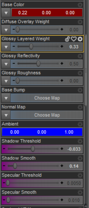

Hi Mada, thank you for that first post, it's helped so much in my understanding of the Filatoon presets.
May i just ask you for clarification on what you mean by "change the black and white to a colour ie red and blue"
is it any of the following two examples or is it something else?
Thank you.
Swapping a custom greyscale LUT for a custom colour LUT.
Or just changing the base colour and ambient colour

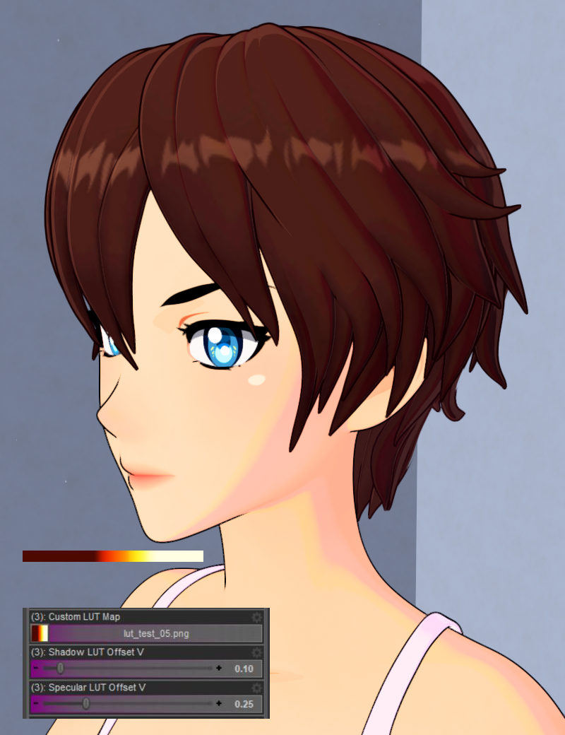

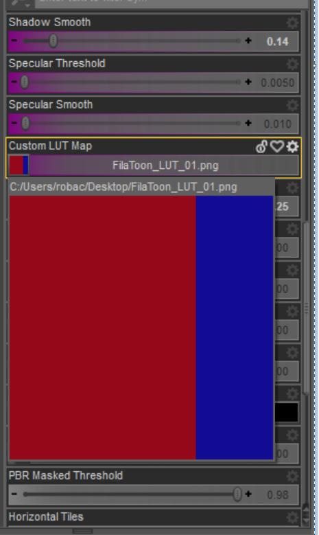

Here are a couple of LUT tests. The images show the strip of "color" I made and saved as a PNG that I put into the LUT slot. Under that the settings I used.
They are really useful examples of the custom LUT maps in action... Thank you.
Thank you.
yes a custom LUT texture map. :) First image.
Thanks for the clarification.
3Diva Thank you for those great examples!
