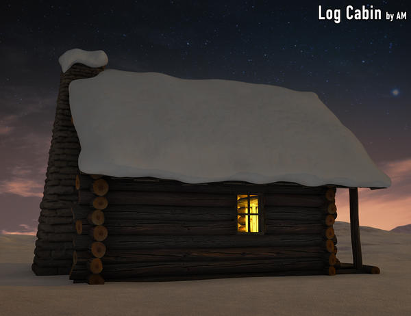

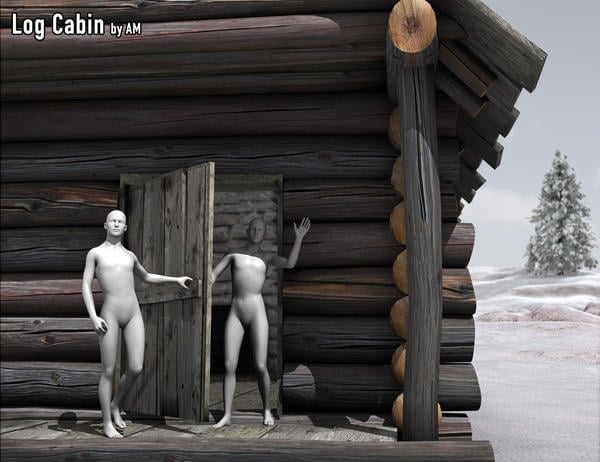

You are going to love this detailed and habitable log cabin, the door is jointed and openable, and all the cabin parts, included the chimney, are detailed also on the inside.The texture are all high resolution in order to provide the best quality for closeup renders.But this is not all: the second cabin version provides a puffy snow cover on both roof and chimney, perfect for your winter renders!
Store link: http://www.daz3d.com/log-cabin-by-am

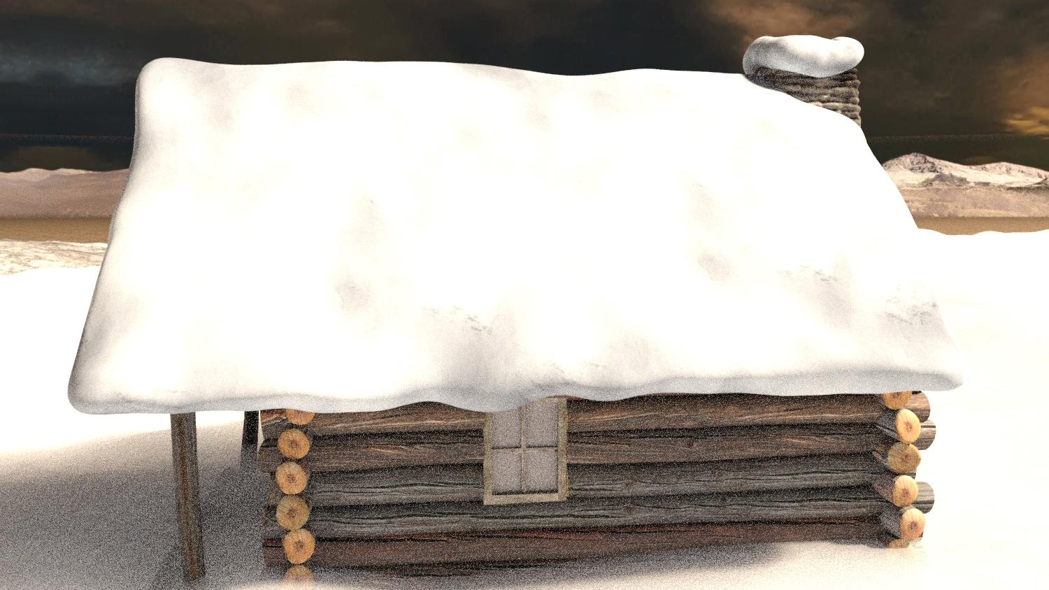

  • No, that isn't is it.  In the attached renders, I applied the Iray Uber Shader and double checked that I had an emission channel as seen in the screenshot.  The applied texture that I have in the surface settings is not seen in the render.  Just for fun, I also applied one of the Iray Shaders, one of the fabric shaders.  I've included screenshots of the particular settings. The fabric texture from the Iray shader also does not show up as applied.  I don't know anything about procedural scripts, but is there something I can do to turn it off?  Or am I right in guessing that this procedural texture you used in 3Delight can't be turned off so that I can use my own textures?  If I have to, I can render in 3Delight.  Unfortunately, I work better with Iray and still struggle getting the look I want with 3Delight.  This is the first time I had tried converting something to Iray and had no luck changing the surface on a product that was made for 3Delight.
    I'm guessing the trees in Winterland (turned invisible in these renders) might also be procedural?  I had left the trees as they were because they were very pretty in Iray.  And they were distant enough that any texture changes wouldn't have shown up in this particular scene I am currently rendering.

    Right, they are all procedural shaders, and IIRC there are no UV's on the snowroof and chimney. So, if you are trying to apply a texture based shader, that won't work.
    Also the snow surface, in the winterland trees, it's procedural, just to clarify...
    BTW, if you know how to do UV's, it shouldn't be too much work to make some for the snow roof, and resave as .duf..
